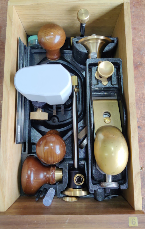

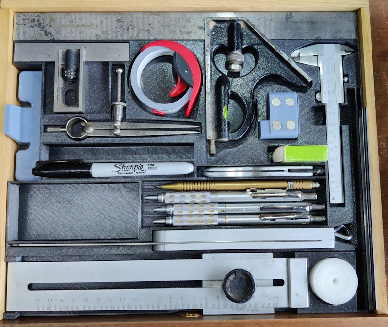

    Since I originally posted the tool chest on here, I've 3D-printed drawer liners for all the drawers to hold the tools that I want to take with me when travelling and to stop them knocking against each other and damaging sharp edges etc. There are a couple of photos below; to see all the drawer liners and read about the process of designing them, have a look in the tool chest build log on my website (the bit about the drawer liners starts on page 126 of the build).
    Travel Tool Chest & Workbench with Integrated Vice-l301_measuring_tray_800.jpg
    Travel Tool Chest & Workbench with Integrated Vice-r601_router_plane_drawer_800.jpg

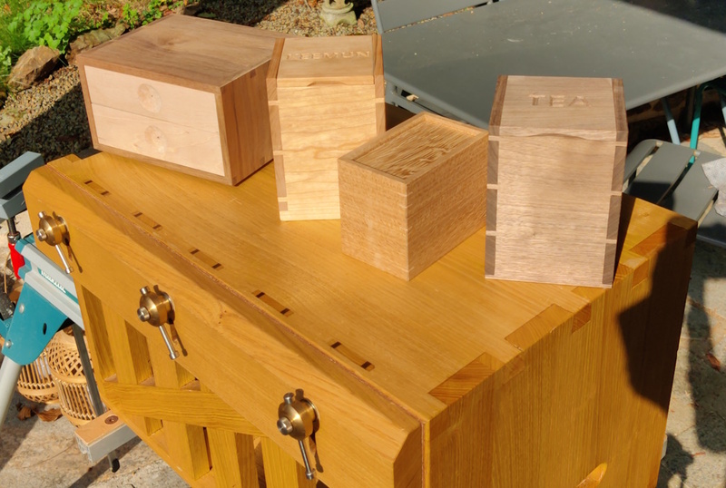

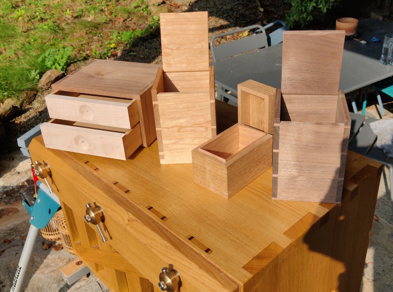

    During the holiday, I made four boxes which you can see in the next two images:
    Travel Tool Chest & Workbench with Integrated Vice-2024-09-22-05-all-boxes-closed_800.jpg
    Travel Tool Chest & Workbench with Integrated Vice-2024-09-22-006-all-boxes-open_800.jpg
    They were all made using the hand tools I took with me on holiday (although the timber had been resawn on the bandsaw prior to the trip). The two similar looking boxes are tea caddies (for storing loose-leaf tea). One is American Black Walnut (ABW) and the other is Cherry.
    The smallest box is made of English Oak. It has mitred and splined corners; the splines (and the liner) are Red Oak. The main reason I made that box was to test the mitre shooting capabilities of the chest's shooting board (which worked really well).
    The final box has two drawers. It's not quite finished as I need to turn a couple of knobs out of ABW (which needs my home-made lathe, which unsurprisingly I didn't take on holiday with me)! The body is ABW; the drawer fronts and the back of the body are Maple and the drawer sides and base are Sweet Chestnut.

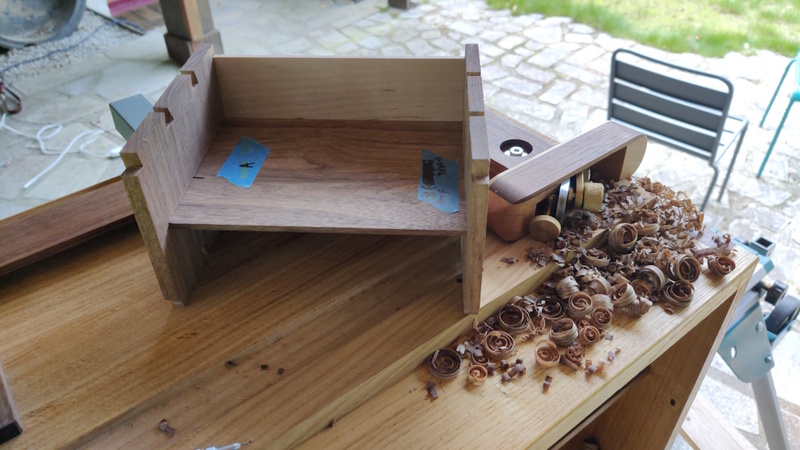

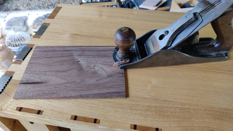

    Planing a bit of ABW:
    Travel Tool Chest & Workbench with Integrated Vice-2024-09-16-24-more-planing_800.jpg

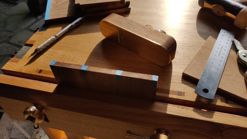

    Using the vice to mark out and cut tail sockets for dovetail joints:
    Travel Tool Chest & Workbench with Integrated Vice-2024-09-16-16-marked-pins_800.jpg

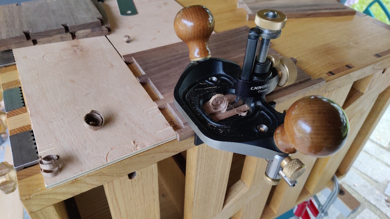

    Ploughing a groove with the router plane:
    Travel Tool Chest & Workbench with Integrated Vice-2024-09-16-20-ploughing_800.jpg

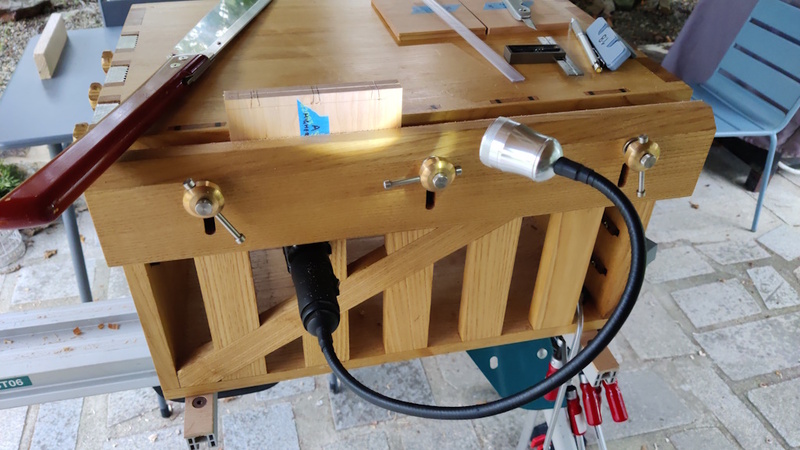

    A lamp clamped onto the back to help with visibility on a rather overcast day:
    Travel Tool Chest & Workbench with Integrated Vice-2024-09-22-01-clamped-lamp_800.jpg

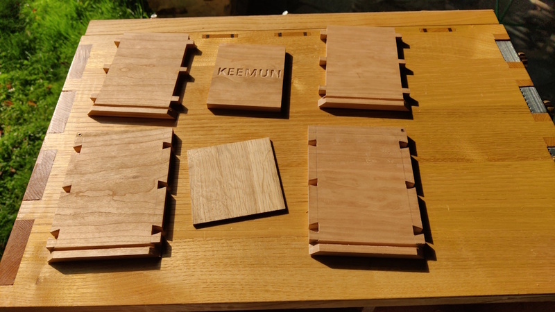

    All the pieces of one of the tea caddies ready for assembly:
    Travel Tool Chest & Workbench with Integrated Vice-2024-09-22-03-cherry-bits_800.jpg

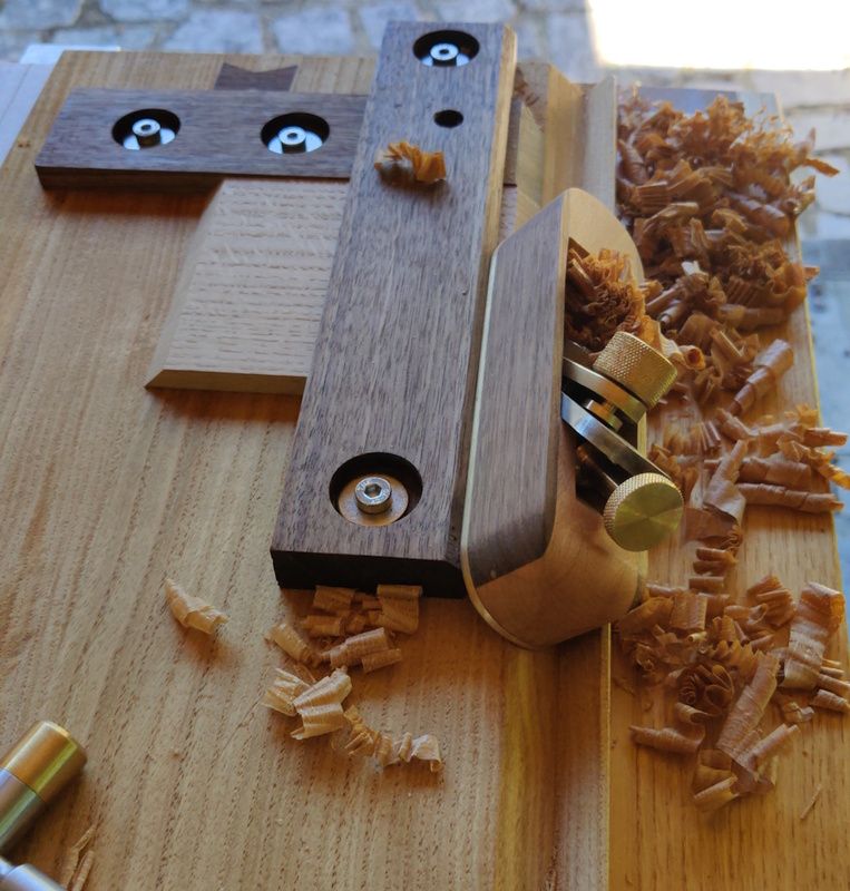

    Using my home-made block plane with the mitre shooting feature of the shooting plane, when making the small oak box:
    Travel Tool Chest & Workbench with Integrated Vice-2024-09-14-08-shooting-mitres-2_800.jpg
