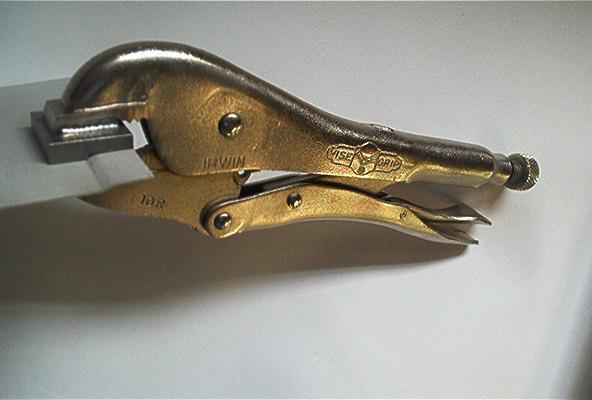

    When I cannot use my rivet drills to drill out the spot welds I slice off the bad panel as close to the lip of the adjoining panel then use an air chisel to separate them Usually once I start chiseling between the edges the spot dimple will show up then drilling it out saves a lot of time trying to cut it away with the chisel or damaging the lip of the panel I want to re attach a new patch panel to. I then grind away any burs or parts of the strip or welds and reform the offset in the edge.

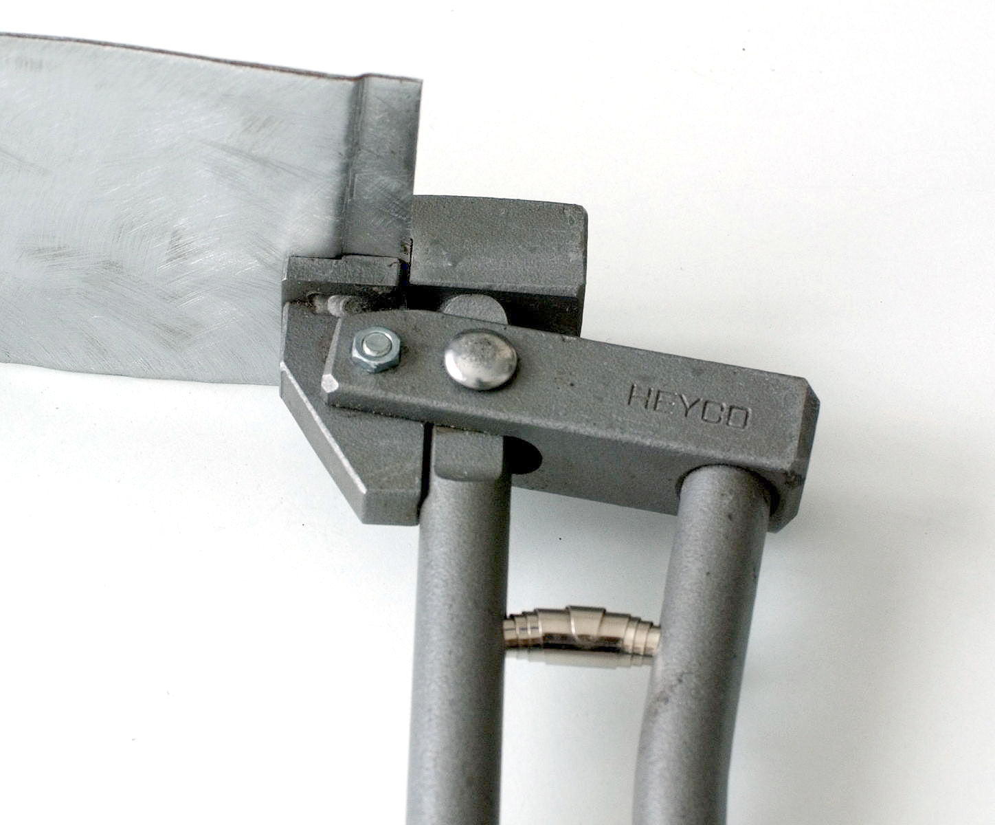

    Sometimes when sectioning in a patch like on the skin of a roof where I am doing away with a moon roof or other patch sections where I am only using a part of a replacement panel what I do is to form an offset in the edge to the panel that the new piece will be attached to by using a sheetmetal edge offset tool like one of these
    I like one similar to this one best as it is faster and offers more leverage. You can make one fairly easy from taking a close look at the picture

    This is the desired profile which is the thickness of the sheet you are adding and about 5/8" wide.

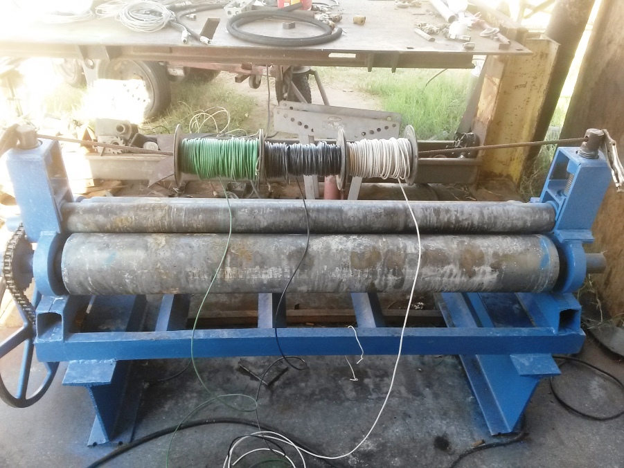

    Since I'm waiting on my sheet steel to arrive to make the air tanks out of on my plate roll I discovered another use for it
    I'm pulling some circuits in my 53 ft shipping container to run some of the equipment in there
    the Plate roll was just sitting there so I grabbed a length of 3/8" rebar slid it through the holes for the top roll adjusting screws and hung 3 rolls of 10 ga wire on it

    10AWG, that's a tough pull, now I see why you ran 1" conduit.
    I made the mistake of running 3/4" EMT on my garage build 30 years ago, I pulled up to 12 (the max) 12AWG TW insulated wires, that was too much work, and I did it solo. I swore if I ever run conduit again I would only use 1".

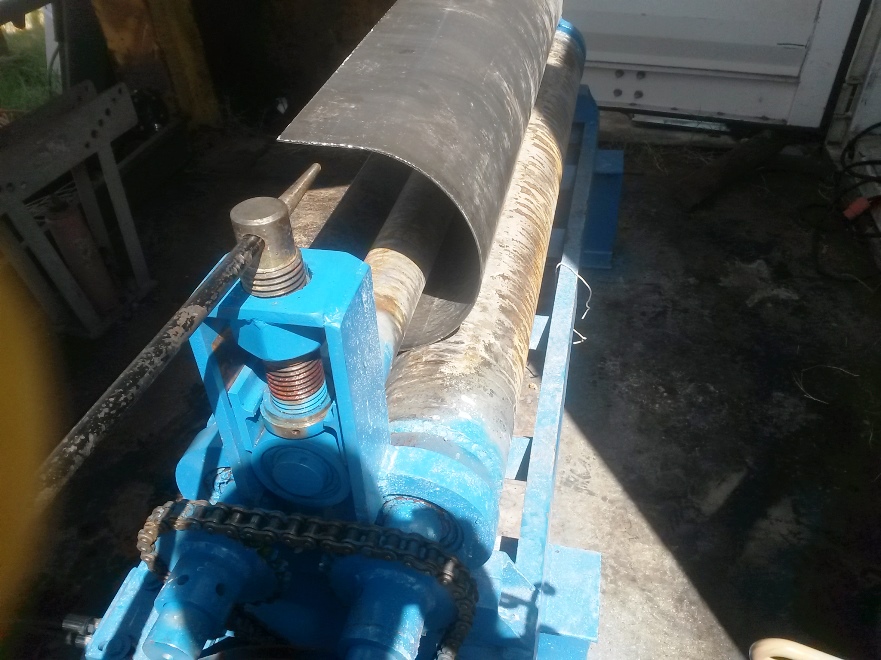

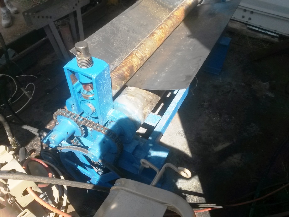

    I finally got around to hooking up my power unit to the plate roll.
    As I suspected even with the almost 10 to 1 reduction I still need to reduce it further but it works fine

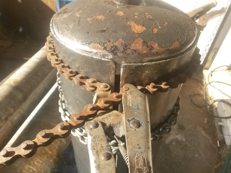

    The ID is 8" so that should have been 25.132" length required to roll but knowing there is some shrinkage I cut the sheet at 25.250" forgetting that I should have allowed at least double the thickness of the sheet instead of allowing only a single thickness. for the next one I will cut the sheet at 25. 400 hopefully this will leave me with a gap of 0.060to 0.090" to weld up instead of the 0.250" I have now which is no problem it will just tale as little longer to weld is all

    This video shows the speed as you can see it is a little fast for doing tight small rolls by yourself
