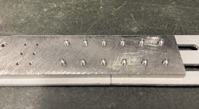

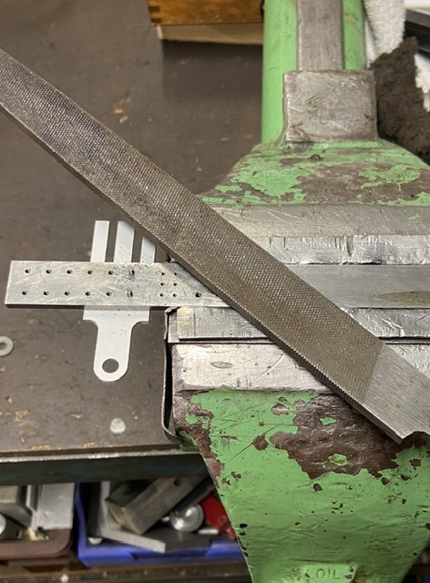

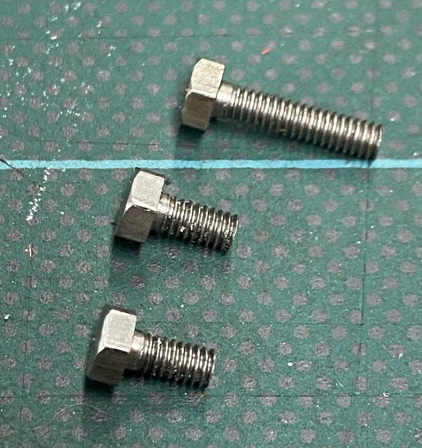

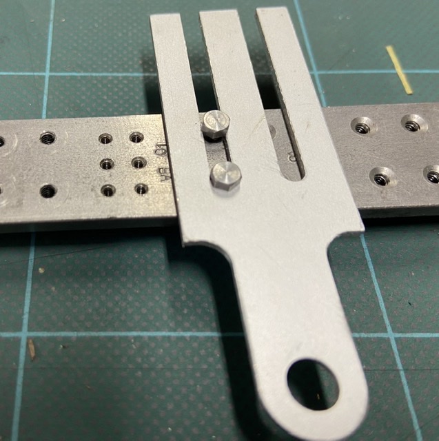

sometimes I have the need to shorten bolts and screws for my models. These are sometimes to small and fiddly to use in my lantern chuck. So I have made a filing jig. A piece of 1/8” mild steel drilled and tapped and I screw the bolts in to the jig and space as necessary to give the desired length. The packers are the same as I use for the rivet shortening tool.
Attachment 34592 Jig, Spacers and 8BA screws to be shortened.

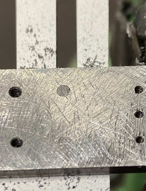

Attachment 34593 Setting length with spacer
Attachment 34594 Screws tighten down onto spacer
Attachment 34595 Attachment 34596Filed down to 1/8” steel

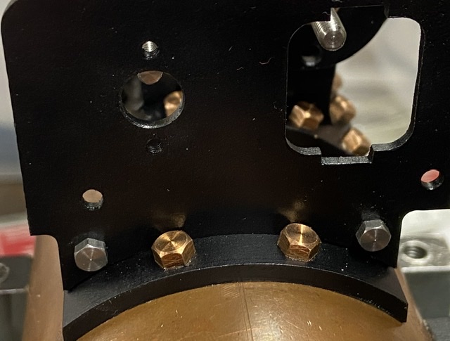

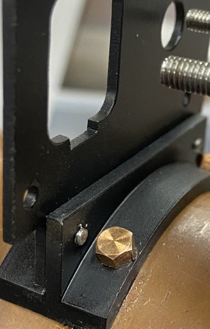

Attachment 34597 Attachment 34598 Attachment 34599 Two screws finished and bolted into place.
I find this a very quick method to get bolts to the correct length.

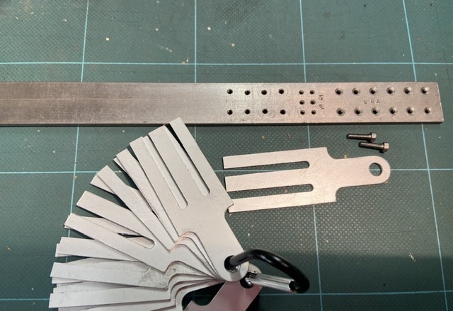

I looked again at your rivet shortening tool, and saw that you have several sets of shims, or packers. Did you make these, or are they commercially produced?
Hi Philip
Hope you and your wife are keeping well.
I made the shims from three different thickness of material I have ordered some 0.5 mm but that was back in January from eBay coming via China but it hasn’t arrived yet. These were cut on a CNC router and made to suit the rivet shortening tool hole pitches. All I do is gang the shims together to get the required length.
All the best
Andy
The Home Engineer
I love your design of your shim plates but that must have been time consuming. The only change I would make is washers parted off on a lathe to all the lengths I needed. Wonderful idea.

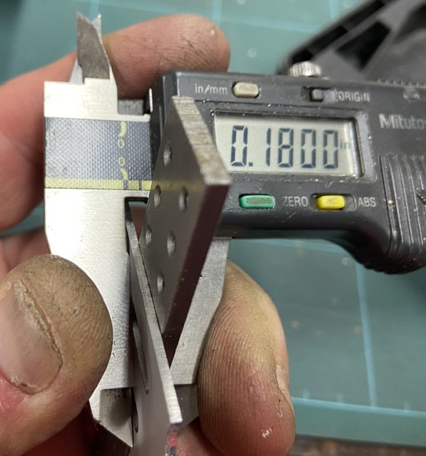

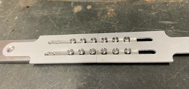

Good to hear from you. Washer work really well and can be made to an exact size. But when you have a lot of screws to shorten the shims are far quicker as several screws can be done at once. Otherwise you would need to make lots of washers all the same length. The Shims I made were produced on a CNC I have access to so while the machine was set up I ran quite a few off but to be honest you don’t need that many. As you could make different thickness Jig plates and drill and tap them with the size bolts you normally have to shorten. Then use the shims to get to the finished size. (No matter what size jig plate you drill and tap you will always want to shorten a screw that you haven’t yet made a plate for).
I had to shorten 24 8BA screws today and it was done in two batches of 12. (See photos below). Like most things in engineering there is always more than one way to get the job done but in the home workshop we sometimes have to get a bit creative. Does not always work but it is very nice and satisfying when it does.
Attachment 34638 Attachment 34639
Filing jig loaded and ready to file down to size. 3/16” under the head.
