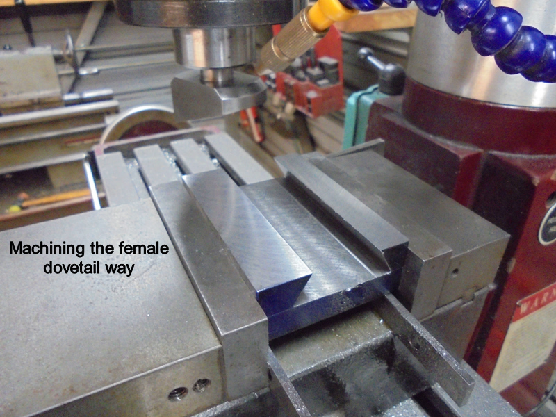

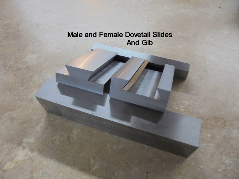

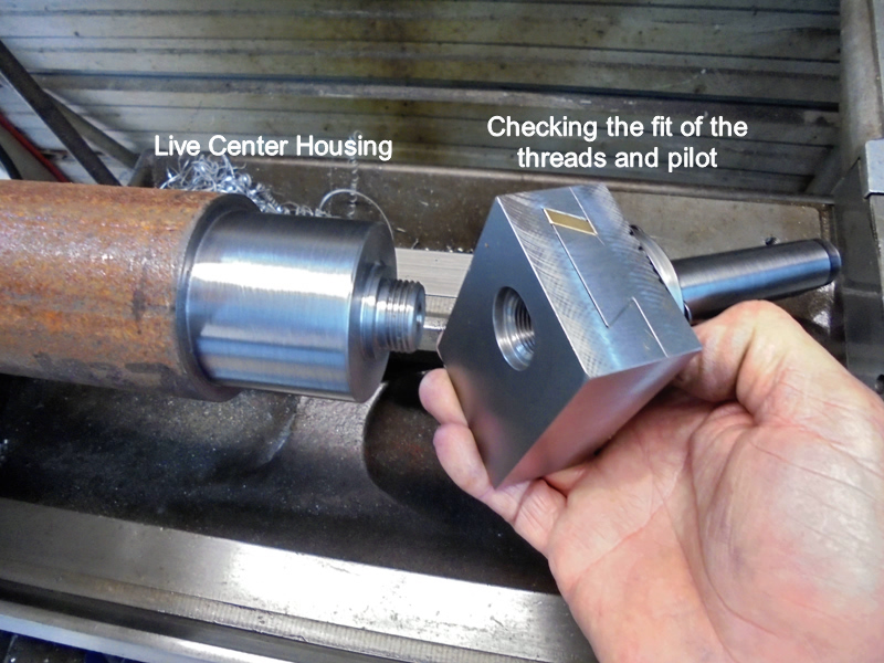

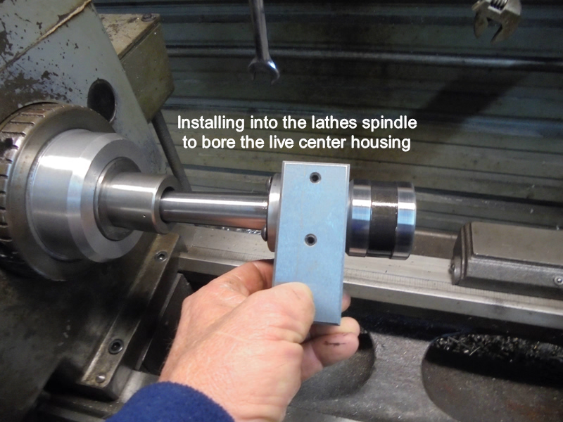

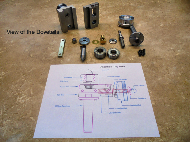

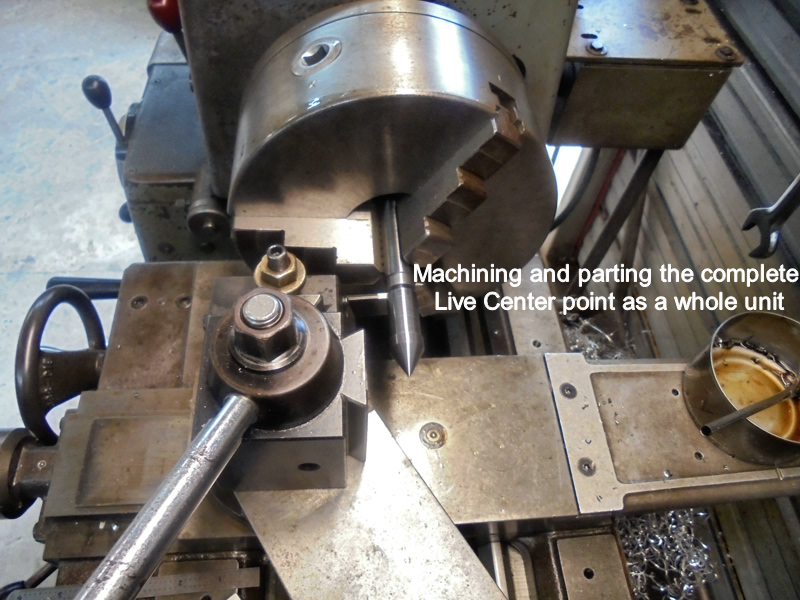

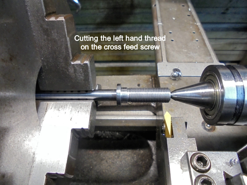

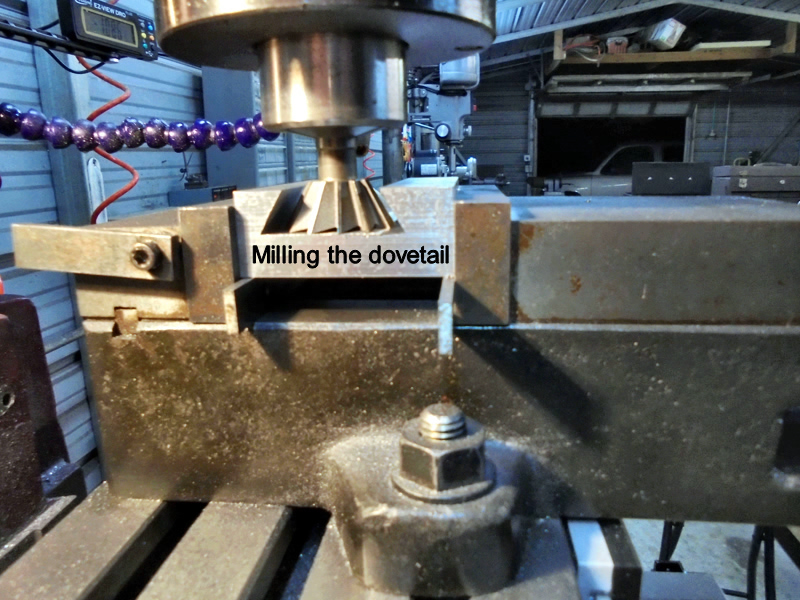

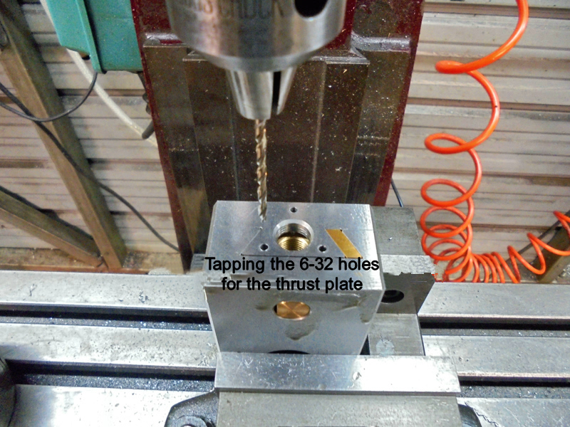

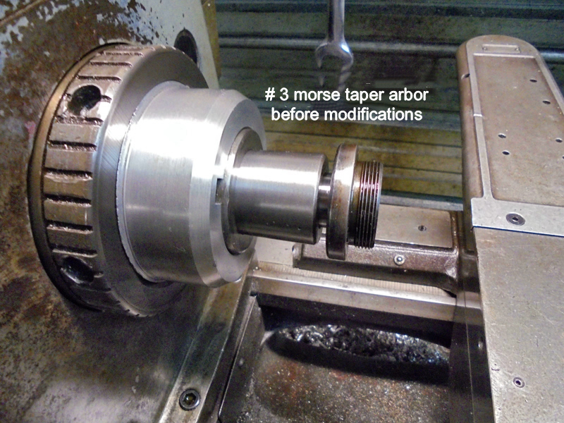

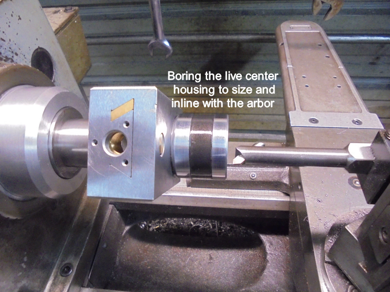

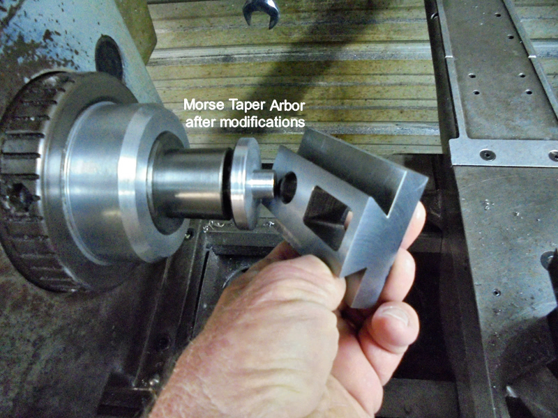

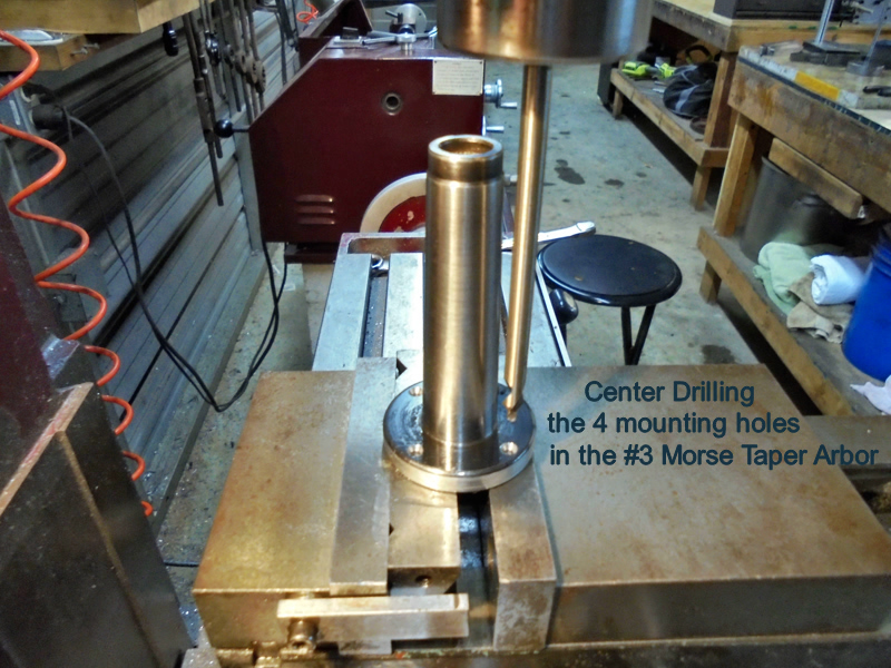

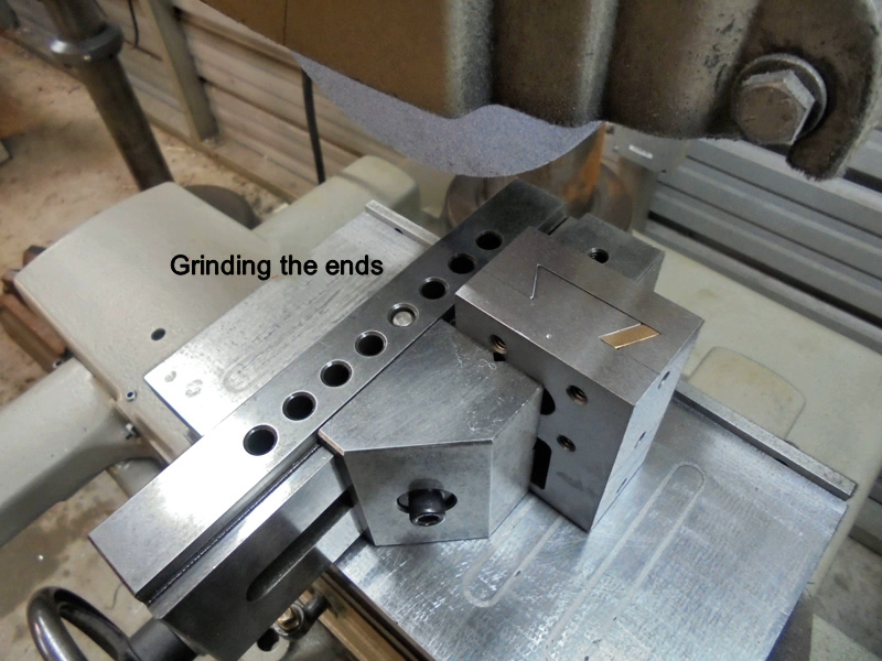

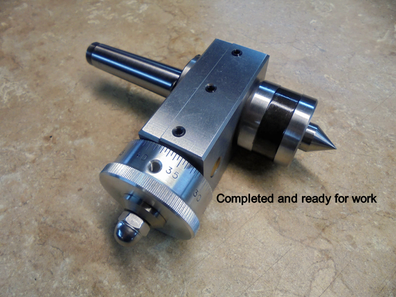

    So by using the same principle as the Boring Head I came up with this dedicated tool that I call the Tail Stock Taper Turning Attachment.
    This tool consists of a Male and Female Dovetail Slide, It has a Live Center fixed to the Female Slide and a #3 Morse Taper Shank fixed to the Male Slide, I had a new #3 Morse Taper Shank with 1.500”-18 threads which was originally designed for a Milling Machine Boring Head that I modified and fixed to the Male Slide, the offset of the Live Center is adjustable by means of a left hand screw and a Graduated Dial that has one hundred .0005” increments engraved on the circumference for precise adjustments, the unit has an off center movement of 11/16” which will cover most any taper I desire.
    This tool can be set to cut any angle, just indicate the live center in with the headstock of the lathe then set the graduated dial to zero, with some simple math you can then move the center over the amount require to cut the angle you want.
    Everything pictured in this post was made from brass, aluminum and alloy steels, I have included multiple photos of the machining processes, a couple videos of the graduated dial being engraved and numerals being stamped, along with a video of the completed tool being used, I am not an actor nor a narrator so excuse my repeated words and or my fumbling for words in the videos.

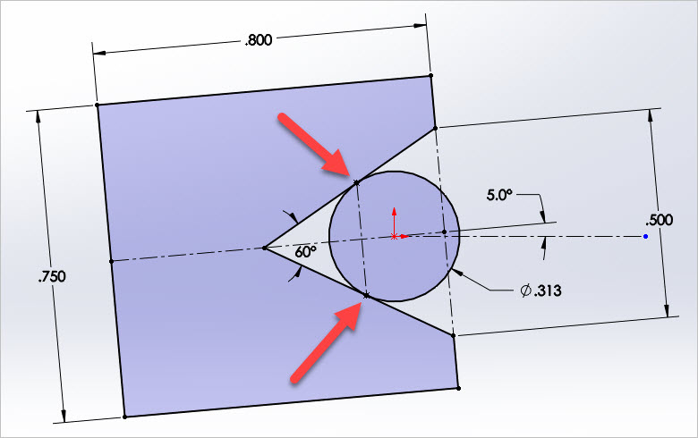

    Because the boring head has 0.500" tool holes, my plan was to make a 60-deg dead center from tool steel because I cant think of a good way to adapt a commercial tapered shank live center into a straight shank. I assume commercial live centers are hardened & ground. Do you see any issue with this?

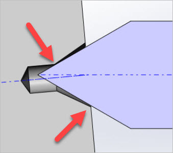

    In terms of the center drill holes on either end of work, I can see the potential for a 60-deg center to only contact a small line of the typical 60-deg center drill depending on taper geometry. Hopefully my pics explain. Ball ended centers might be a good plan, but that's another thing again. For insurance I got some some type-R center drills. Any words of wisdom in that regard?

    Making your dead point center is fine, that's what I did, look at photo 20 of my post, my center was made from 4140 pre hard steel, I then further hardened the just the point.
    Use a bell type center drill they put 2 angles in the large end of the center hole, you can get those from most commercial tool suppliers.
