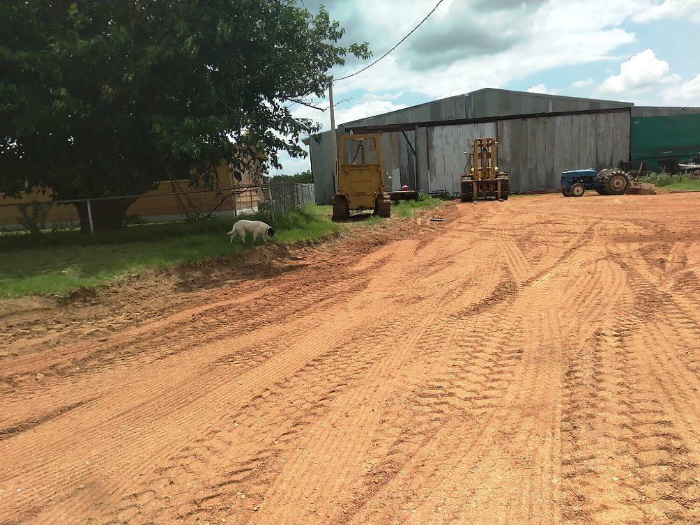

    Everyone who knows me are probably familiar with my work shop or lack there of conditions.
    For many years I have worked under my tent shop I've moved it around several times It is pretty good in the summer , great for providing shade and blocks much of the summer winds But it is horrible in cold wet dreary windy weather especially when the winds are out of the NE or east.

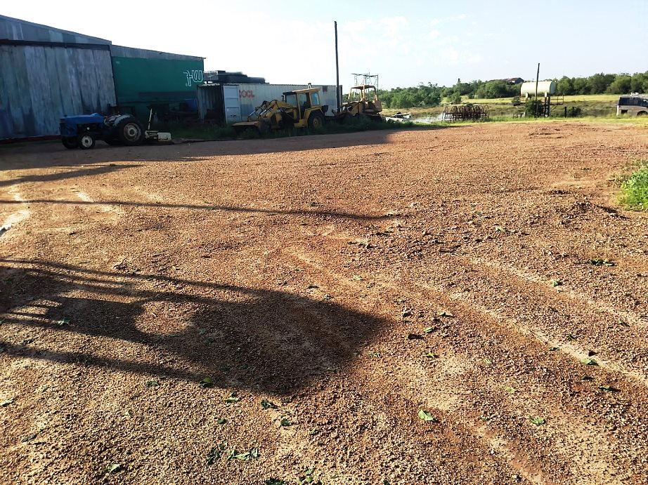

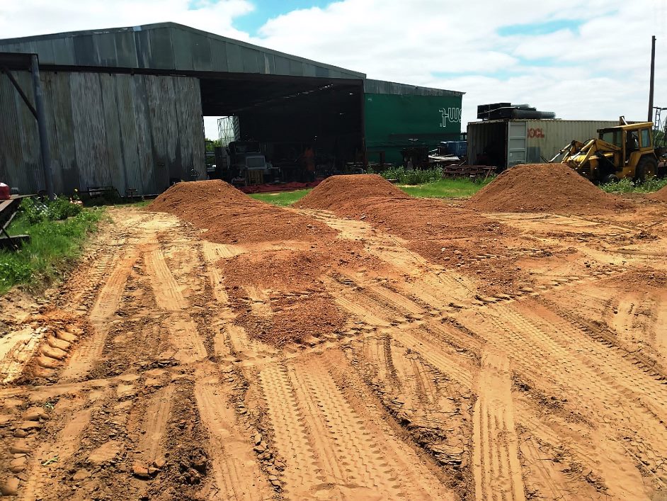

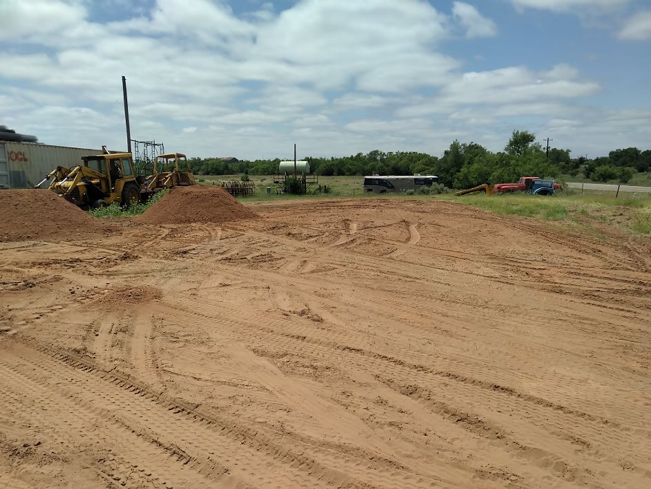

    For the past several years life has always got in the way of my starting my shop so today I decided to at least take the first step.
    So since life on a farm always has more things that need doing than can get done I finally decided that if I just get 1 column standing I will be able to say that I am starting on my shop. So today this happened
    Of course first I had to pull some stumps that had been nagging me for a long time then remove a tree from a fence and remove the fence but those were not going to stop me from my goal. I removed a tire from an old 24.5" truck rim then welded it to the bottom of a 7" sch 80 pipe. the pipe was not long enough to suit me since it was only 12 ft long I welded a 10 ft section to it then dug the hole with my backhoe . I went down 6 feet deep before I struck hard pan. now my column is not long enough again I wanted 18 ft walls. I added another 4 ft to the pipe. then hefted it into the ground with my backhoe
    I am not cementing these columns in the ground I prefer to have a large base on them then back fill with dirt & clay tossing in a bag of portland every few layers adding water and tamping
    Tomorrow I will try to get my whacker packer running It should run just fine since it only has about 30 minutes of run time since brand new. but I've had it for several years I hope I drained the gas out.
    Once I set up my scaffolding (I have enough to set up an 18 ft high run about 60 feet long so working from a ladder is never in my job description) I will fill each column with sand dirt gravel and used motor oil I have a concrete vibrator that I will strap to the columns to pack the dirt and oil inside of the columns.
    There are a couple reasons for my doing this 1 is it makes them infinitely stiffer 2 it prevents them from ever rusting out from the inside and 3 it deadens any sound transmittal should I decide to add things to them like a thick plate for hammering on or mounting a bench grinder on. also by being stiffer if I weld a pull ring to them they won't have a tendency to bow, they wouldn't anyway since so much else will be welded to them in the form of building materials and bracing.

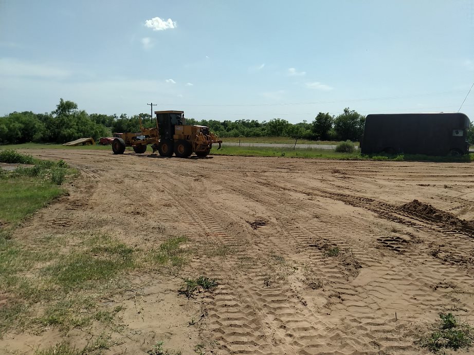

    A little better progress today even thought eh wind was 20 to 30MPH most all day

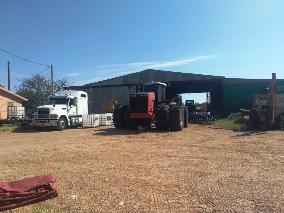

    3 days of climbing scaffolding dozens of times, hanging off the rungs of the scaffolding while welding is just about to get old for this old man. However I can see the light in the tunnel growing nearer with each passing day I think it may the a search light on a UFO or a train but the shop is coming along.
    now have 4 of the 5 trusses in place and some temporary x bracing welded in place just encase things have to go into slow motion for a while I don't want the wind to wreck what I've already done.

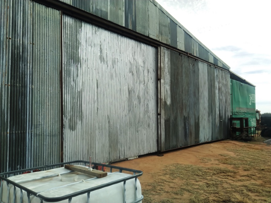

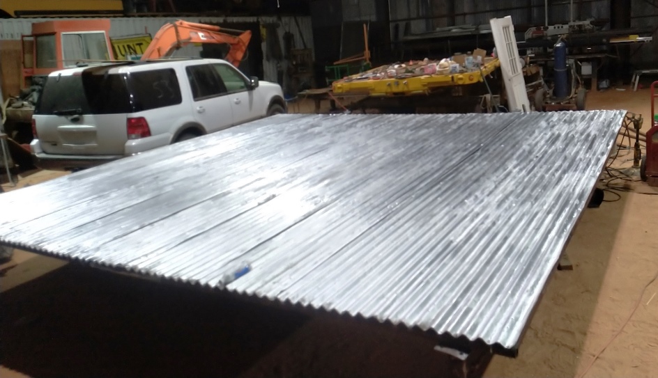

    To be honest I should start a thread called how not to build a shop building.
    A few things I have been thinking of doing to it as time goes along. First off I have a School buss that is just sitting in the woods collecting weeds around it. It has a good diesel engine I need to pull out to be installed in one of my "B" model macks that I want to turn into a pickup or a flat bed straight truck the buss though body wise is in great shape and would make for some really good mezzanine storage atop of the shipping container So what I will do is remove the body from the frame cut it off right at the windshield cut the skirt off the body so the bottom of the floor of the buss will sit flat on top of the container roof This will make a great storage area up out of the way of everything else.
    There is a good chance that I may do this to the 2 trusses on the West or Entry end of the shop a lot depends on how much excess materials I have laying around
    Took the first step towards building my shop-27652d01bb7f36458564bb73222558e1-oklahoma-bridges.jpg
    If I do then I can construct a 15 by 68 ft. office space between them and still maintain the clear span opening for a 3 top hung sliding door opening allowing me to have a 44 ft wide opening from either side or just open a 22 ft. wide single section
    this will also mean I will have a place to construct an elevator to lift materials to the mezzanine where the school buss will probably be placed and then on up to the office floor.
    But it will also mean that the building will wind up being 28 ft tall in front instead of the 24 ft height at the center of the trusses now
    But it will give me a lot more sq footage. Actually by the time the 45 ft machine shop van is attached to the South side and the 26 ft tool and bolt storage van attached outside of the East or the rear of the building I will have close to 6000 sq ft of useable floor space while still only having to pour a 4000 sq ft slab
    The plans are also to add a 38 by 40 ft lean to canopy on the south side to park my tractors and other equipment under
