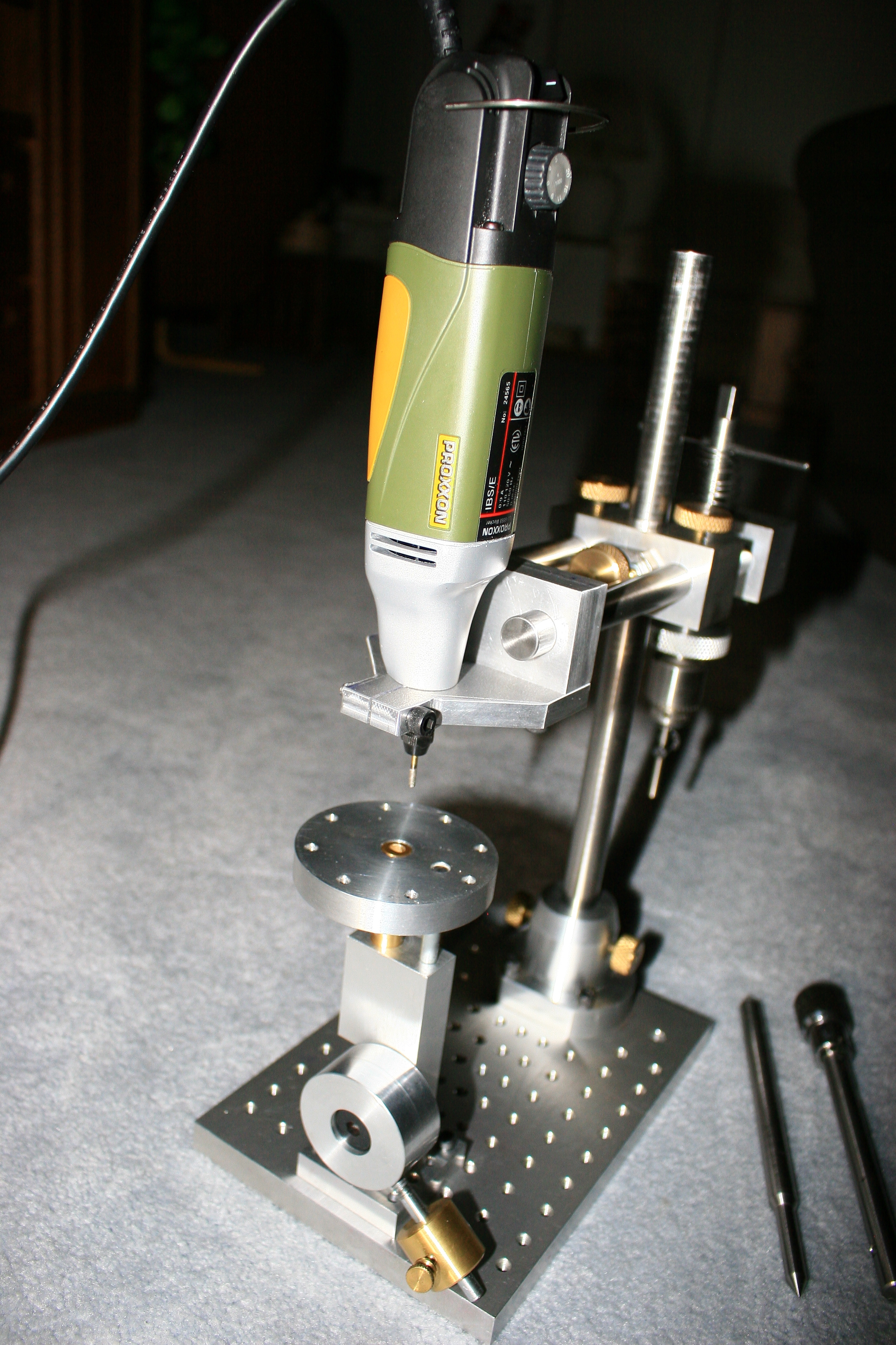

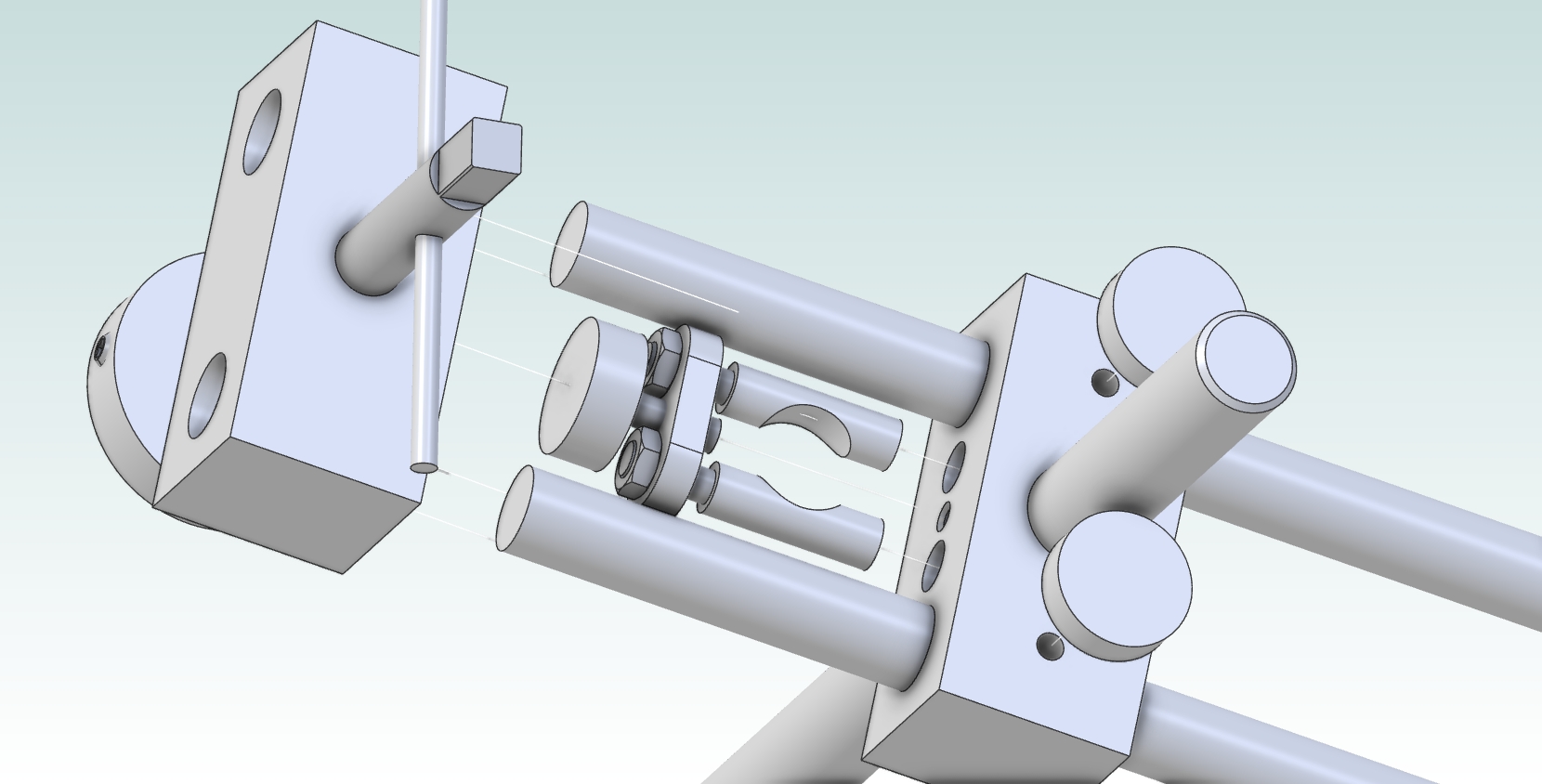

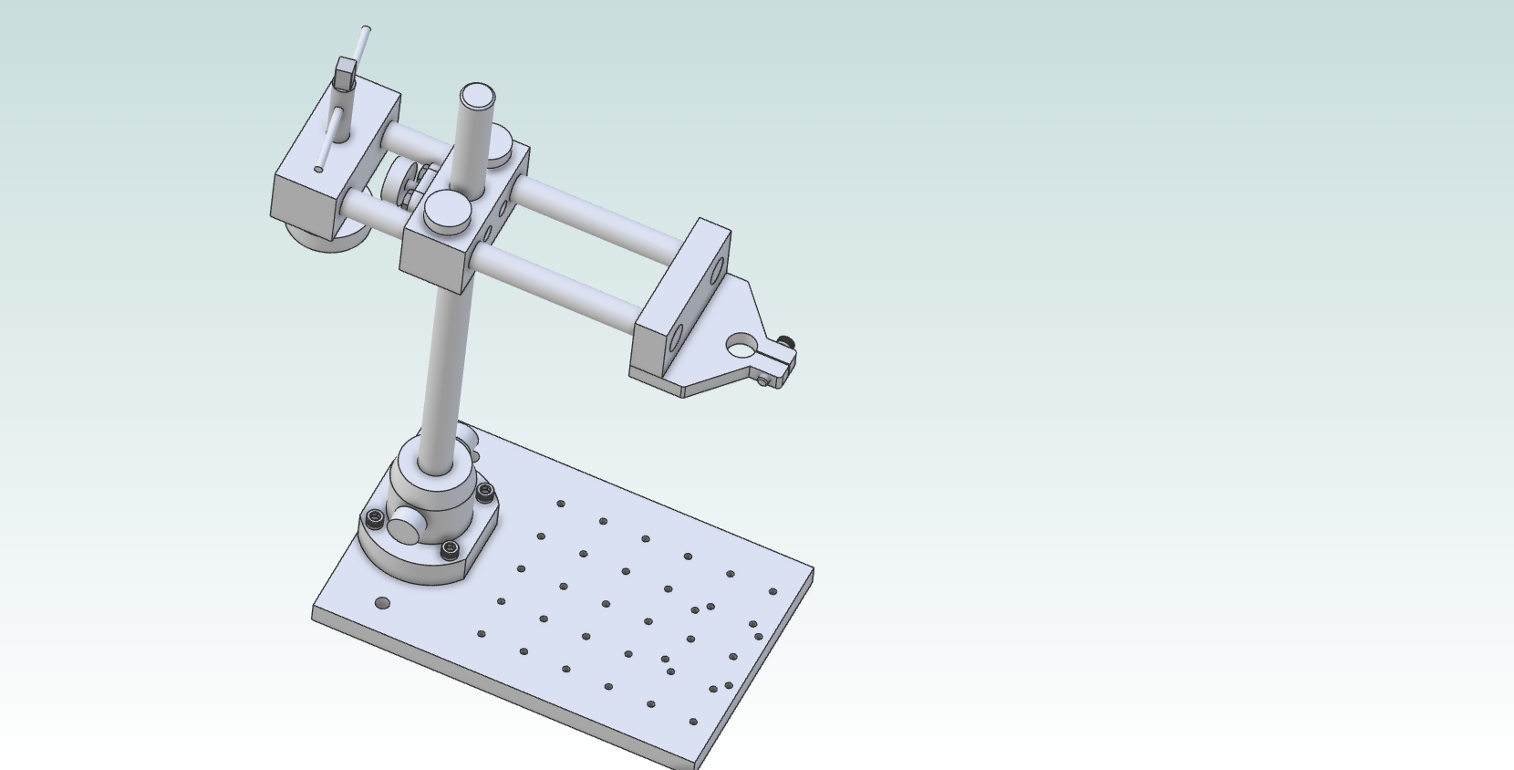

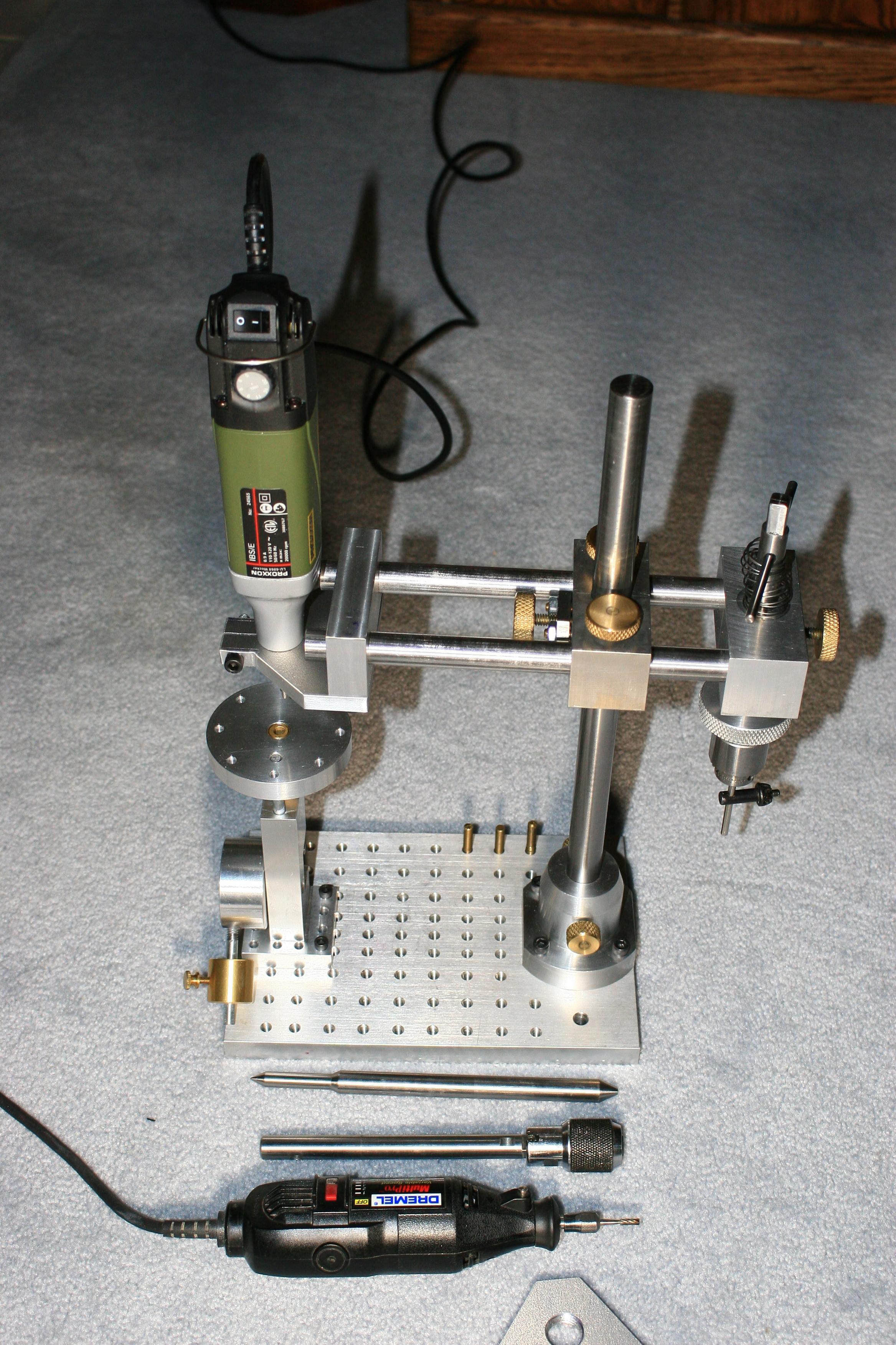

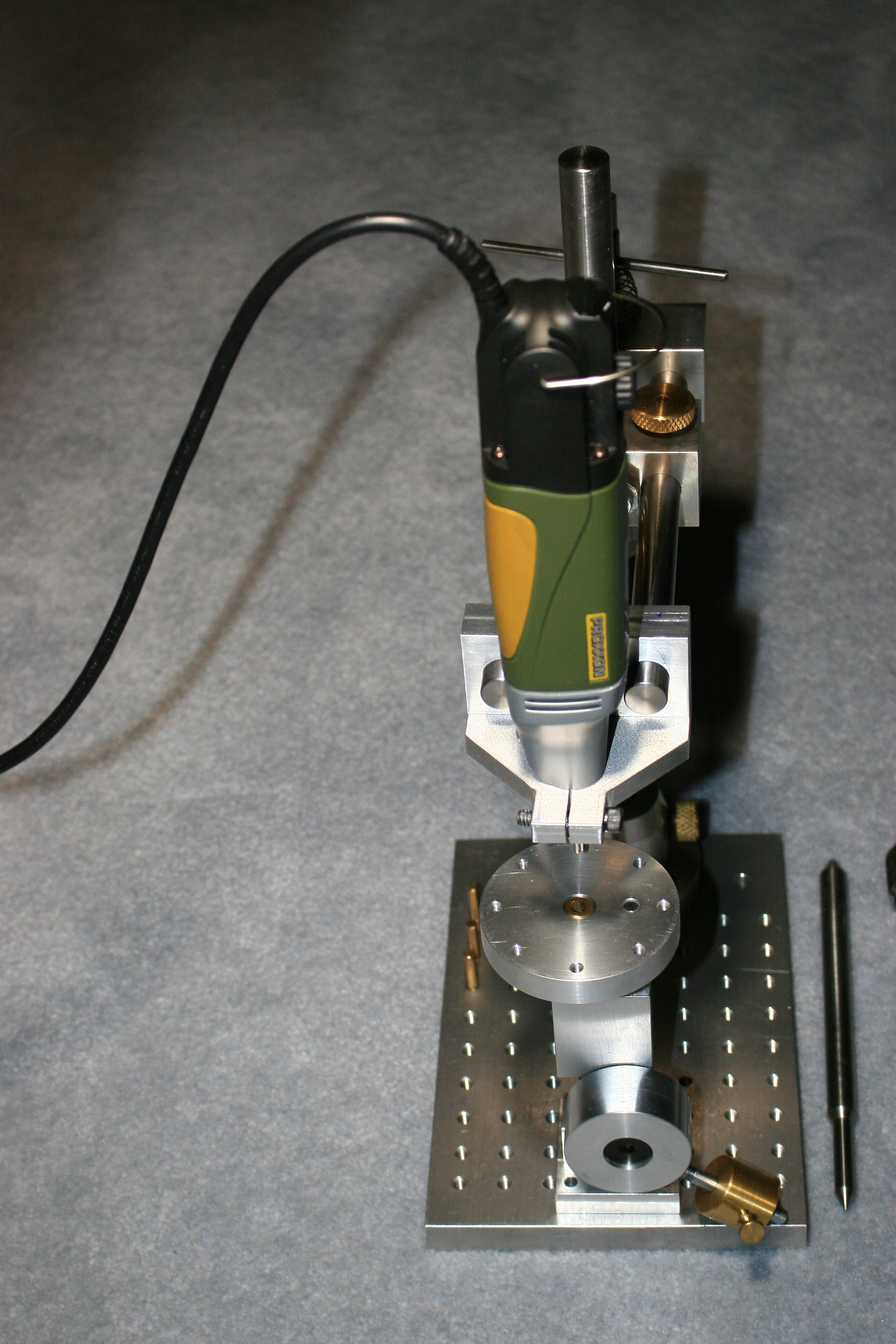

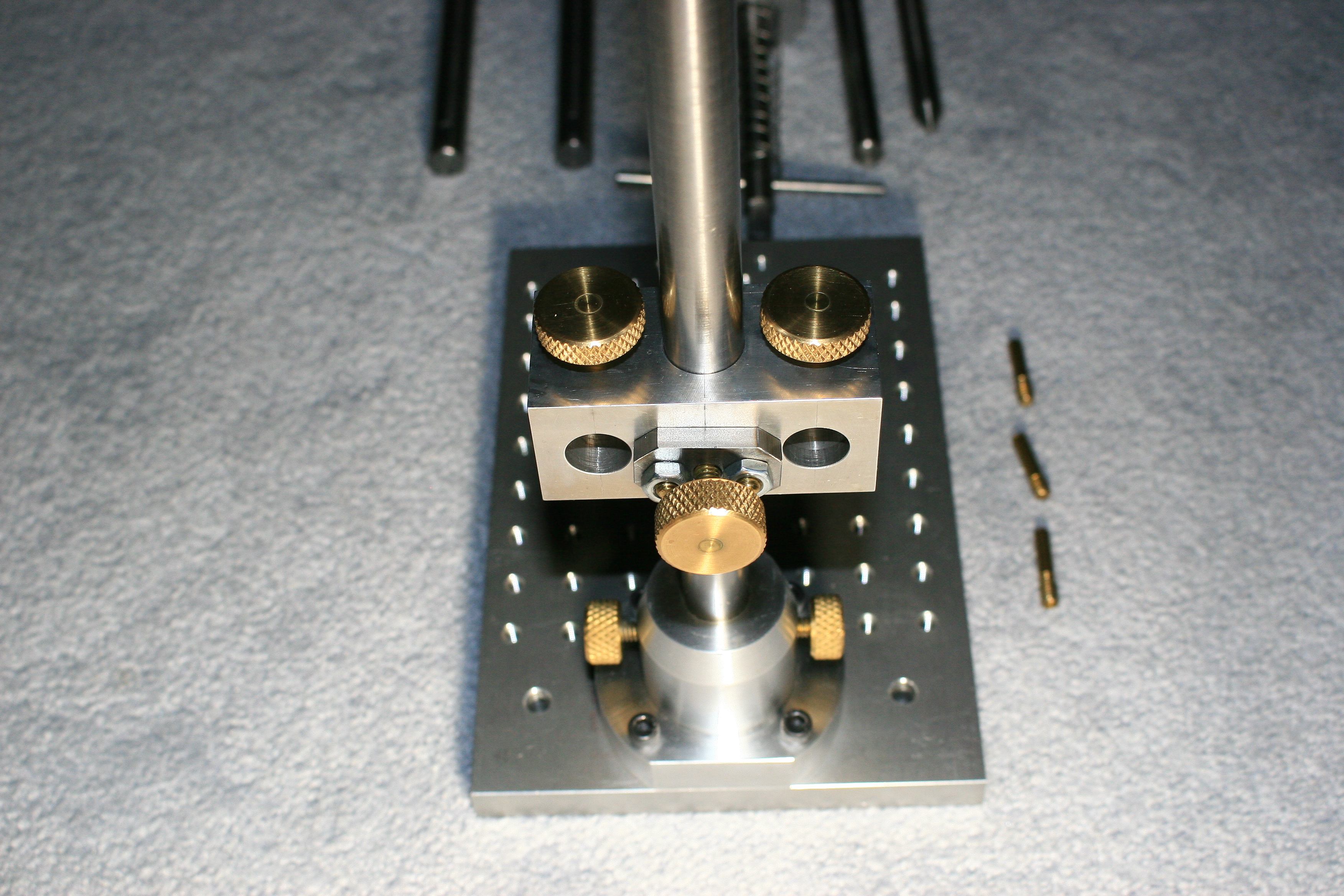

The post below is the sensitive drilling platform I made last year.
Sensitive Drilling Platform with plans

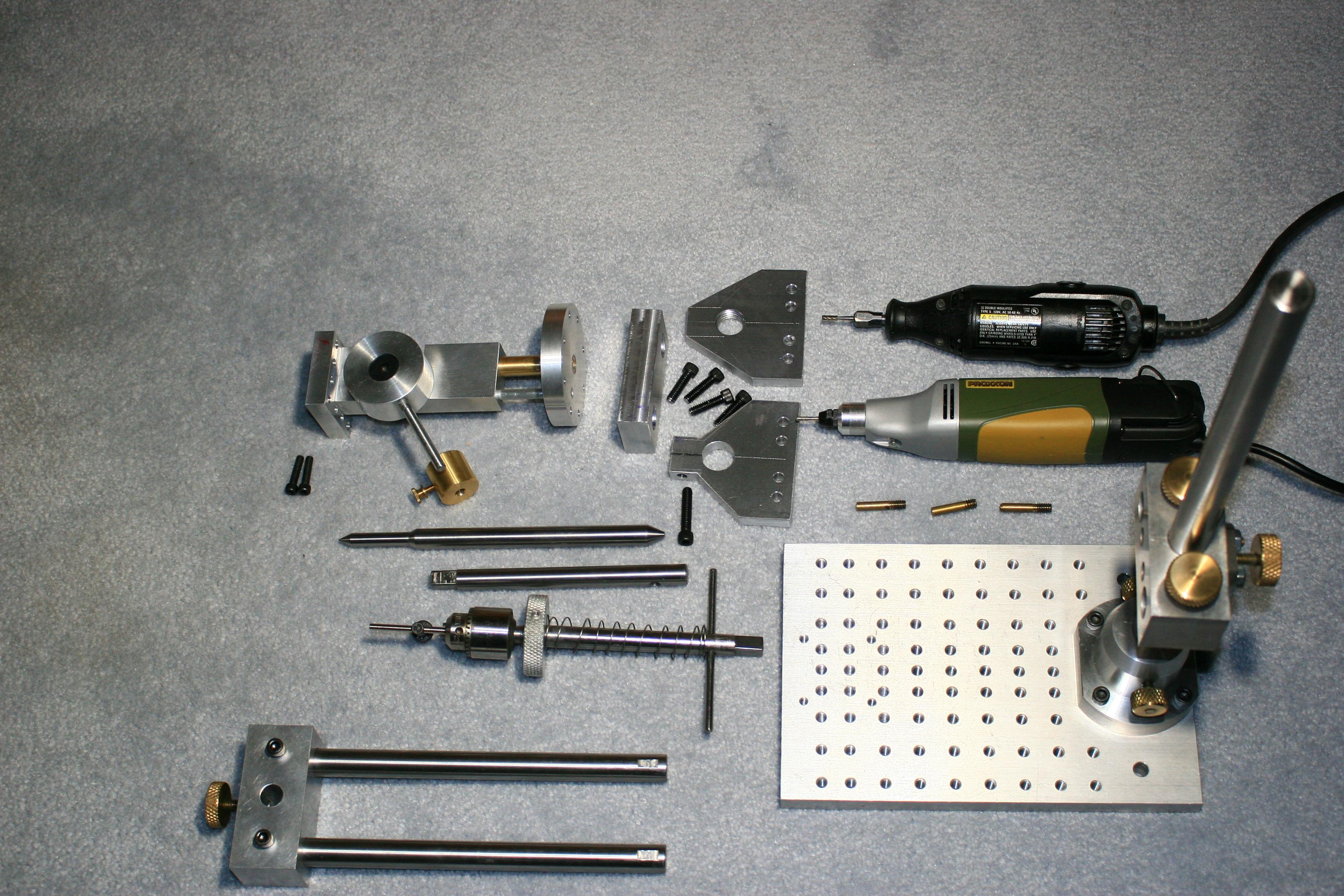

I had also made a tapping stand a few years ago so it became obvious to me that
with just a little modification I could combine both and have a system for using very
small drills and taps. The system is not limited to very small taps and drills but can also
be used for work up to about 1/4" or so.

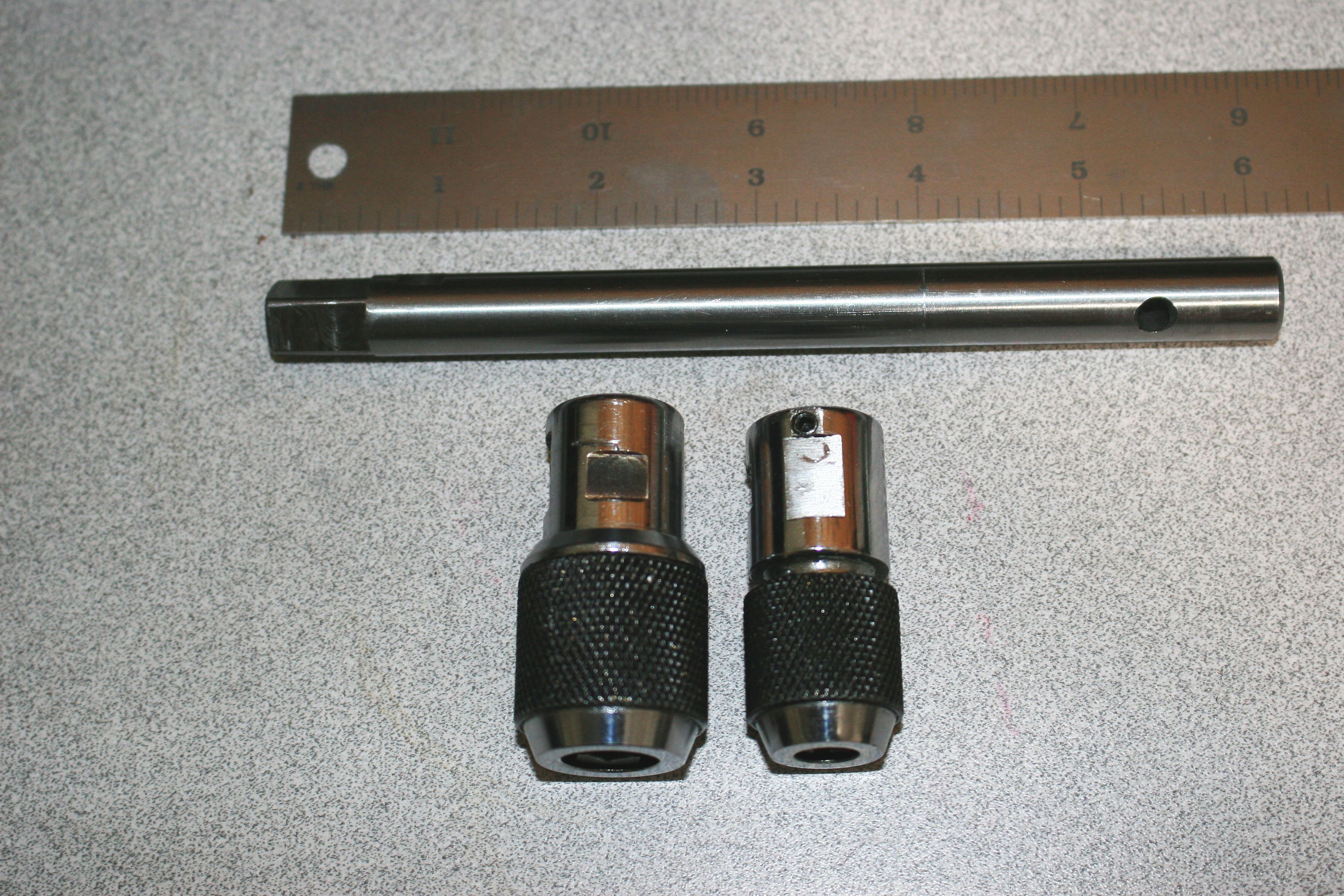

Here is the link to the original Tapping Stand, I did not have plans for this at the time I
built it so I will include the plans for it in this post. Here is the original Tapping Stand:
Tapping Stand or Hand Tapper

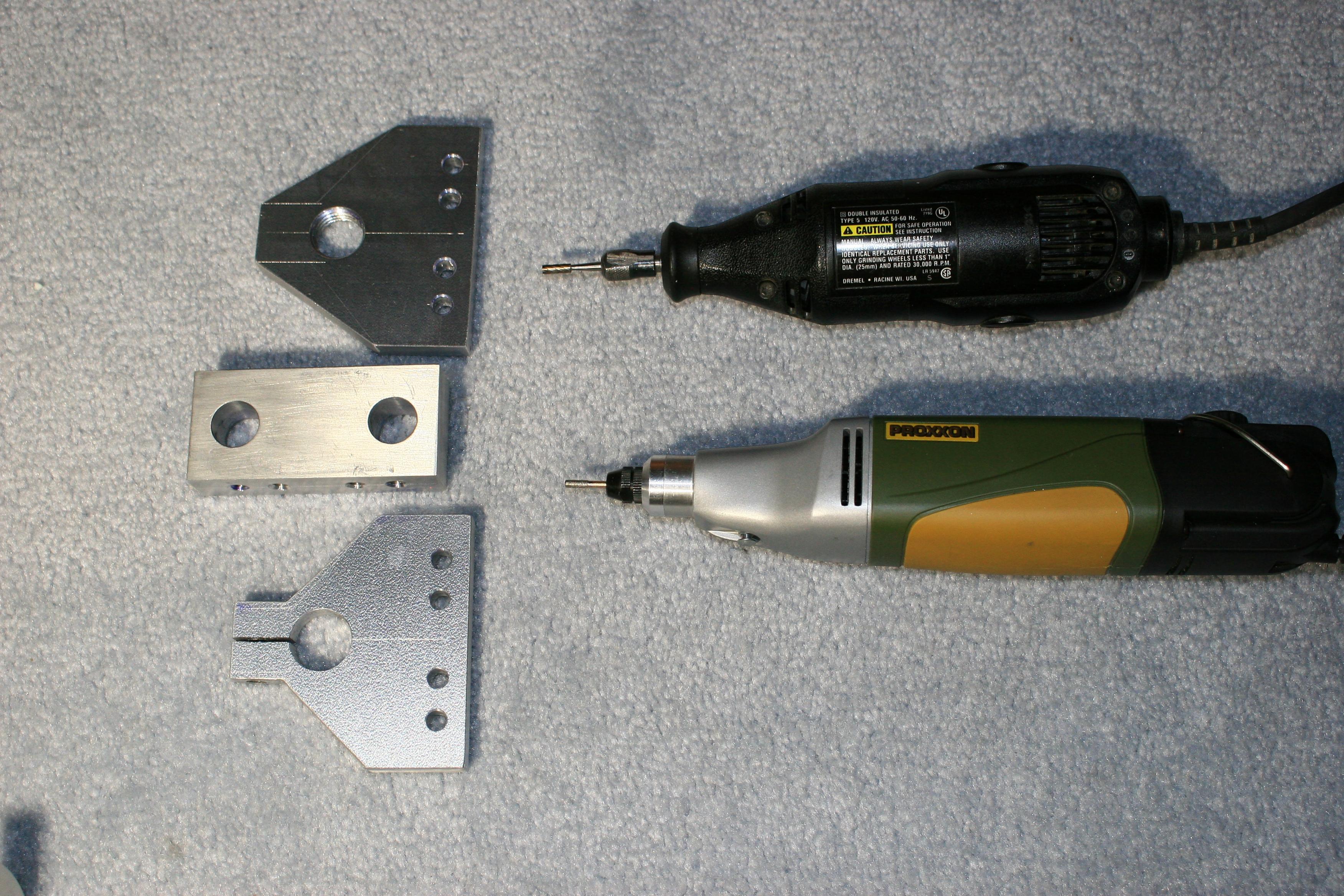

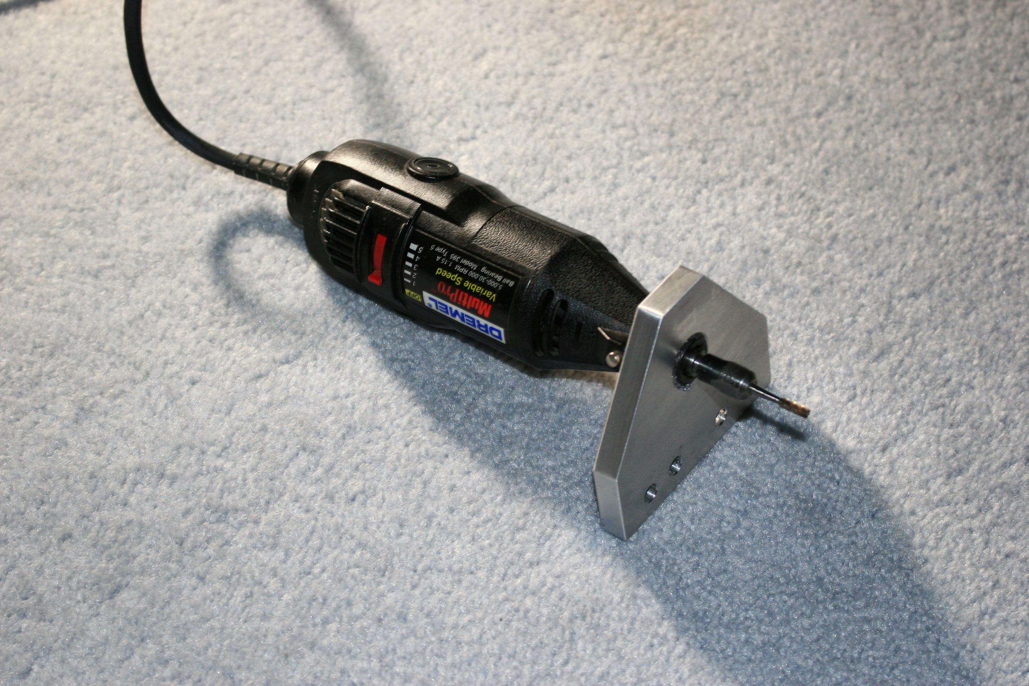

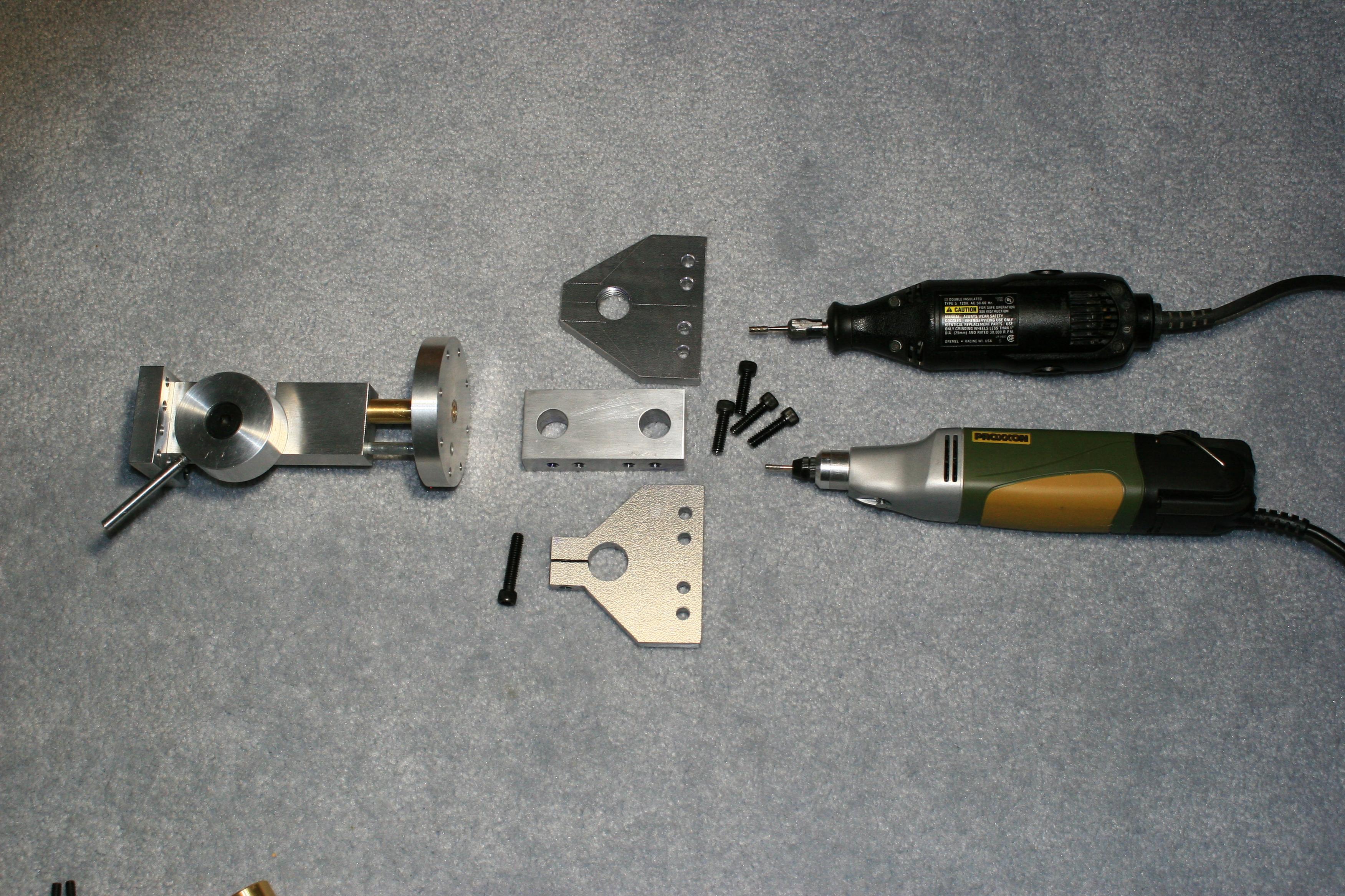

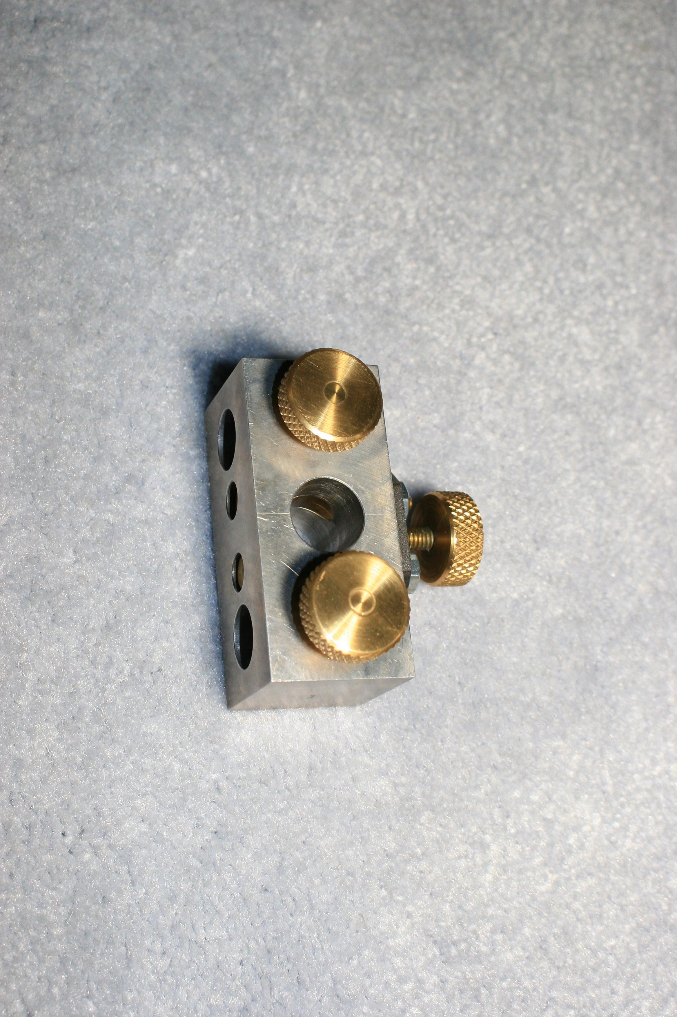

Both Dremel and Proxxon rotary tools have new adaptor plates in this post that have
not been shown elsewhere. The Proxxon is a superior tool that is quiet, very smooth and
I have found it a real pleasure to use.

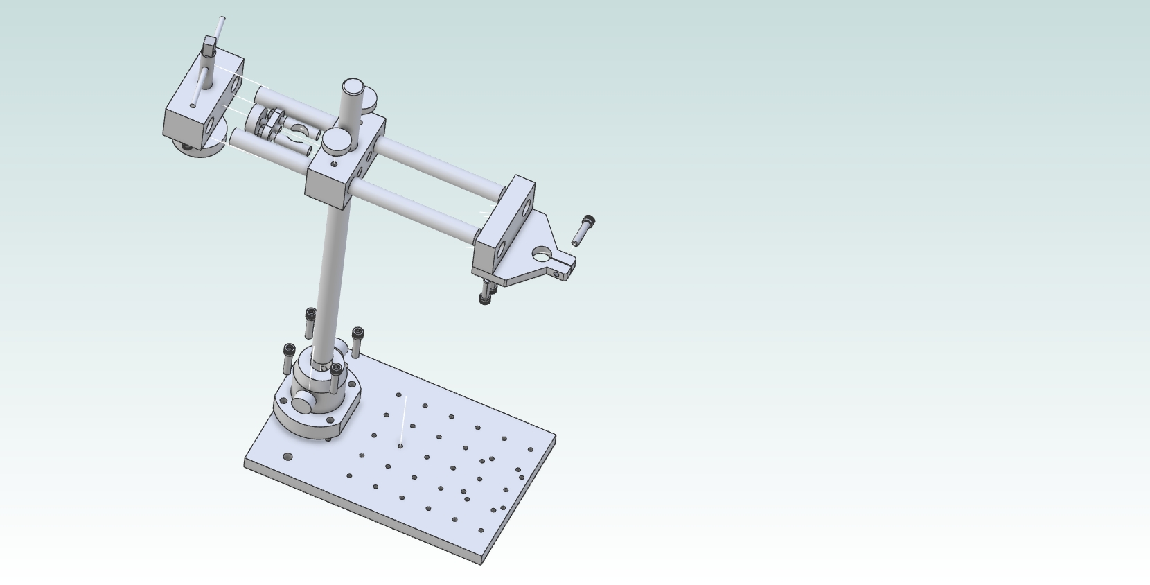

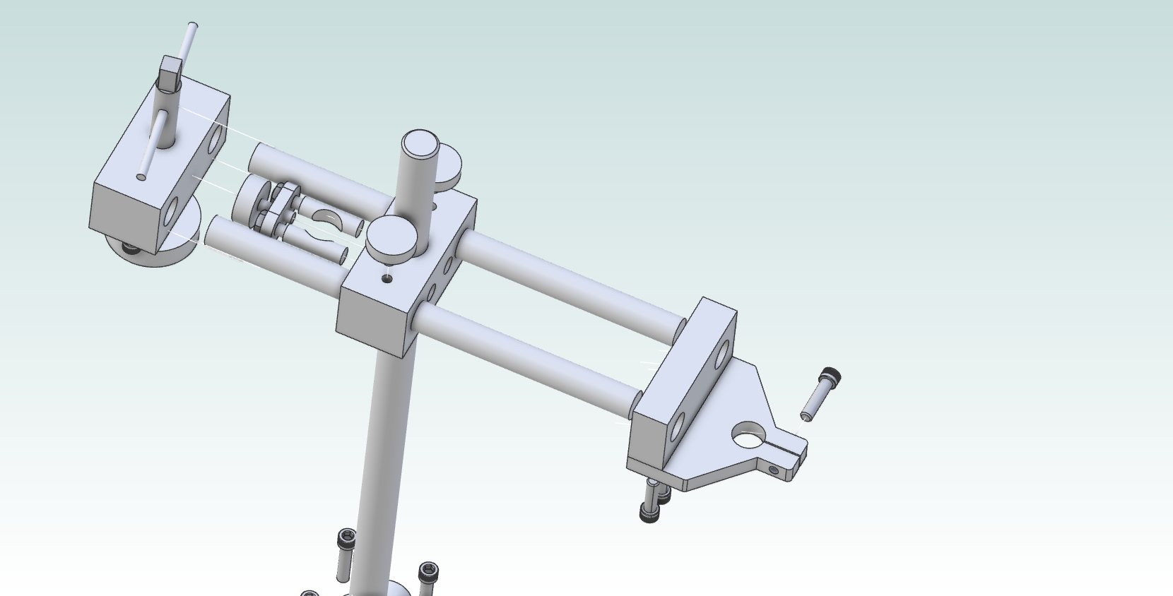

Here are the plans for the tapping stand and the adaptors for the Proxxon and Dremel:
