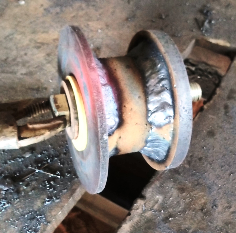

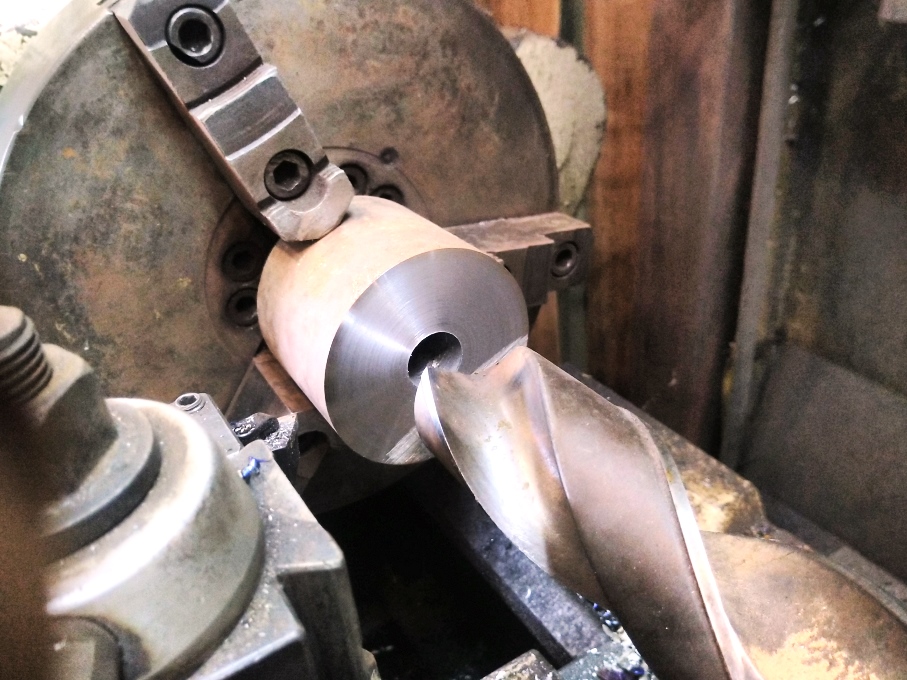

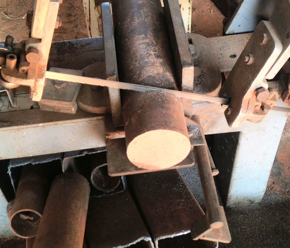

    The beginning of the rollers is a length of 3 1/2" round bar
    A 2" hole was bored through it

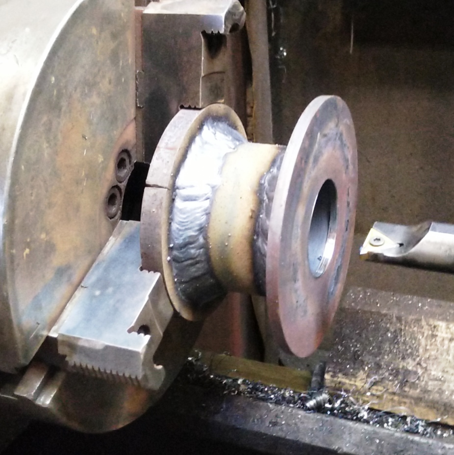

    Then flanges welded to it to allow for the profile machining of the roller

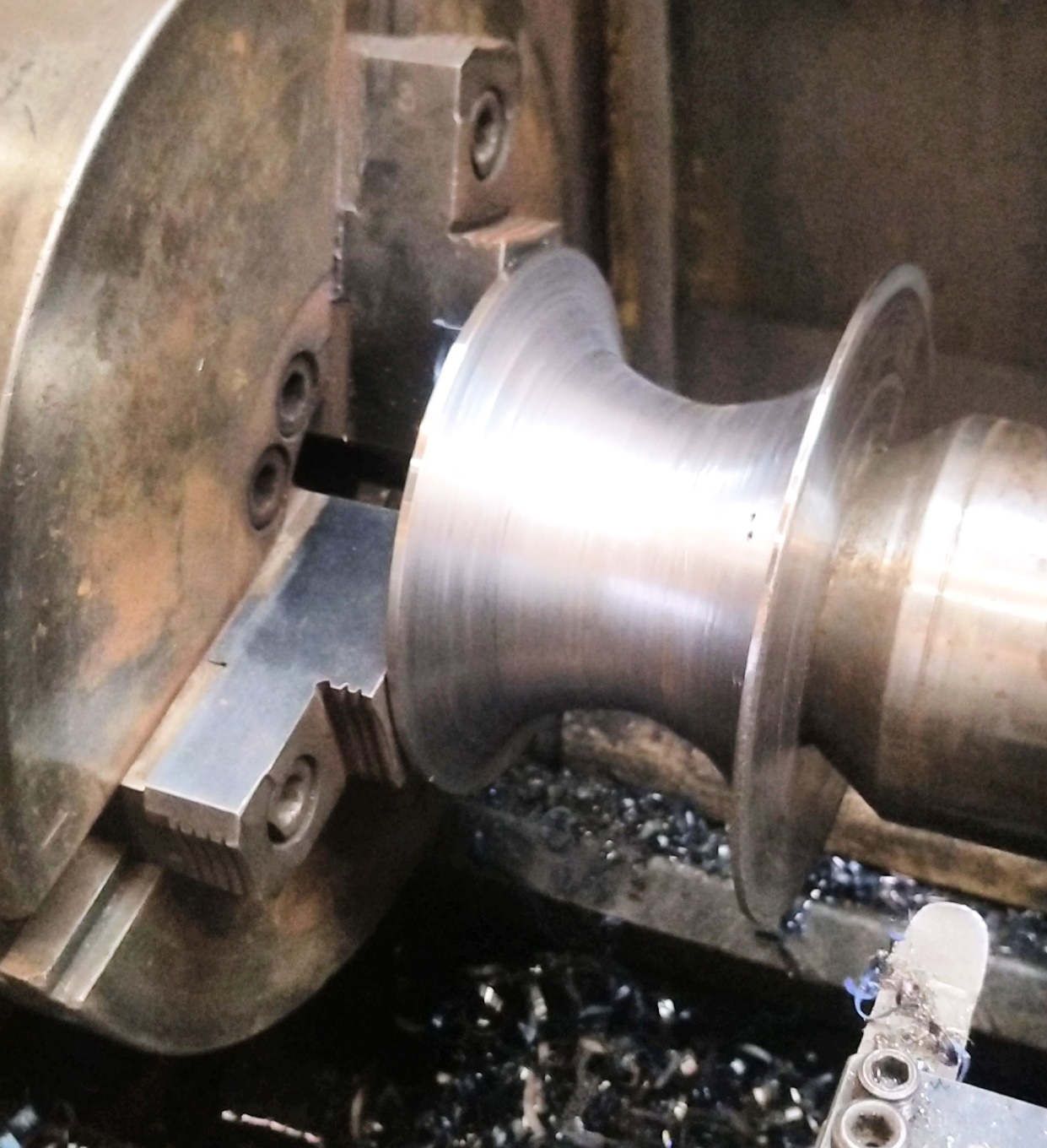

    Machining the bearing locations for 6306 bearings 30 Bore x72 OD x19 mm wide
    Machining the profile

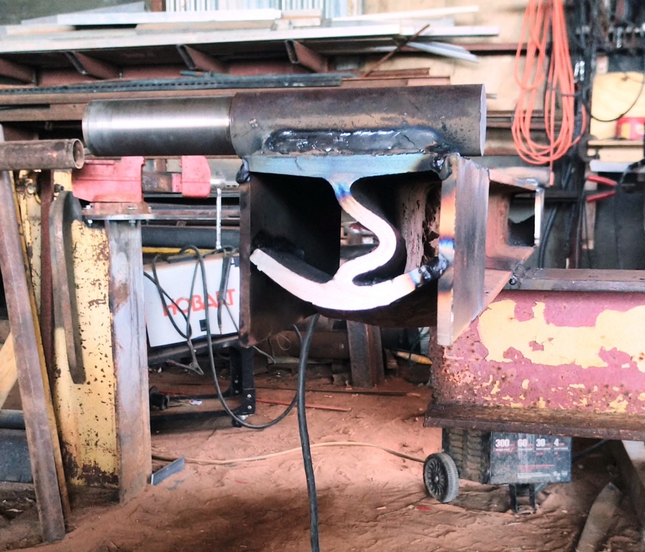

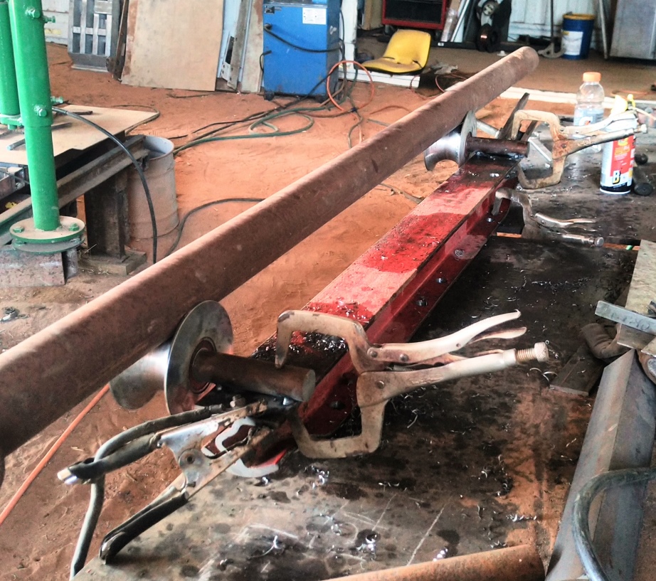

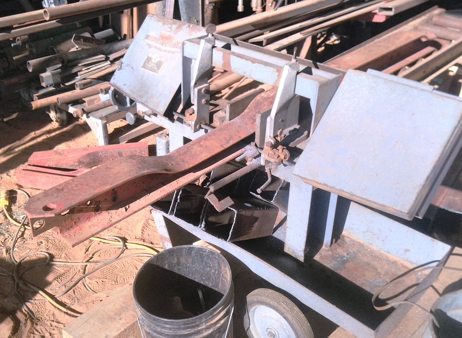

    I had a pair of cross rails from an old Globe 8000lb 4 post lift that I used for the end trucks and bracing of the bridge

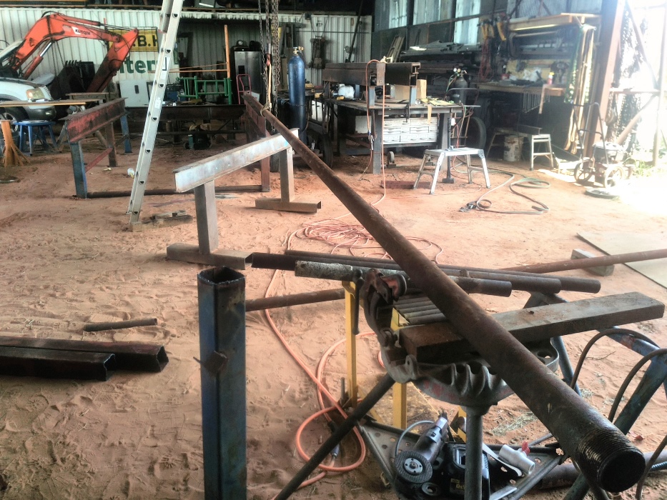

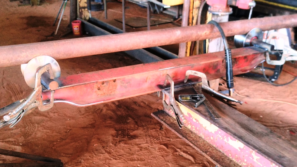

    View of 1 end truck assembly using a length of pipe for aligning

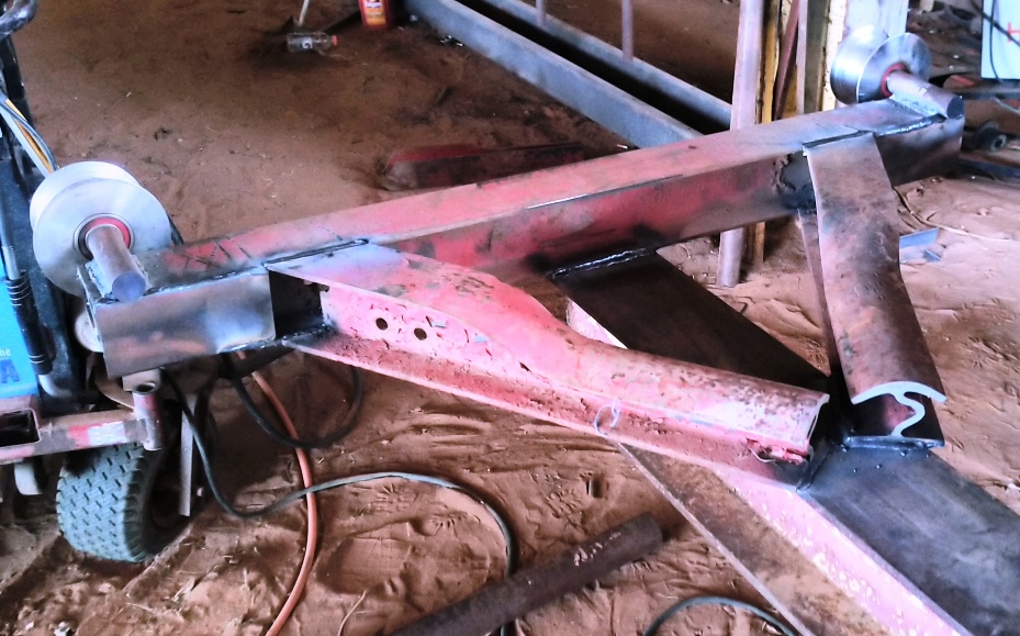

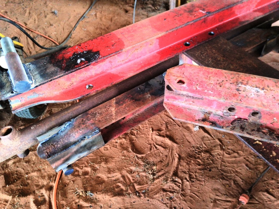

    View of the end of the end truck with spindle welded in place note the compressed state of the end of the cross rail beam I used this proved to be beneficial in my design.
    Aligning the spindles for welding

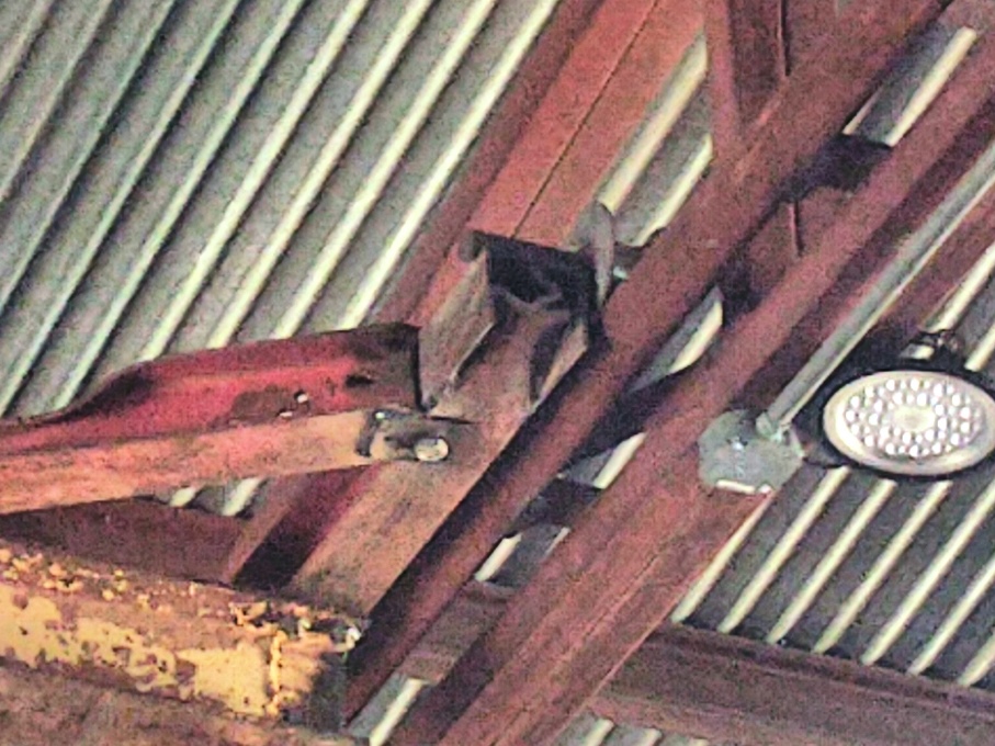

    One end is bolted to the top of the bridge while the other end truck is welded this was done so the bridge could be installed. Note how the compressed beam pieces cut off from the ends of the cross rails worked out for bracing

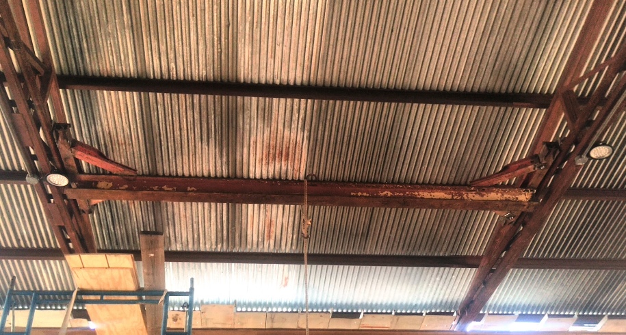

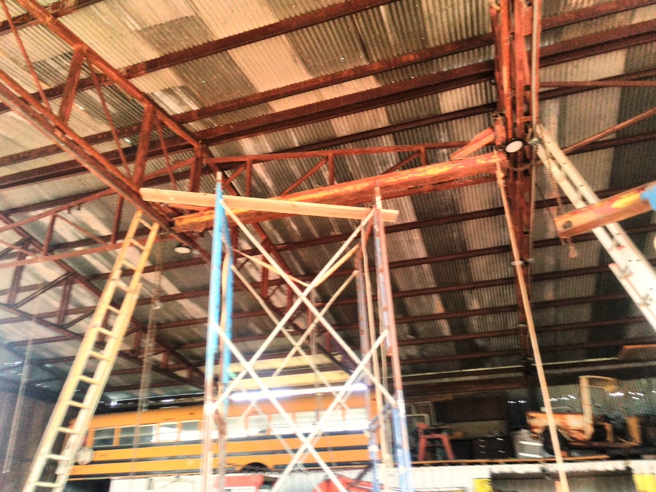

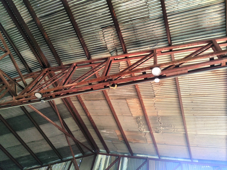

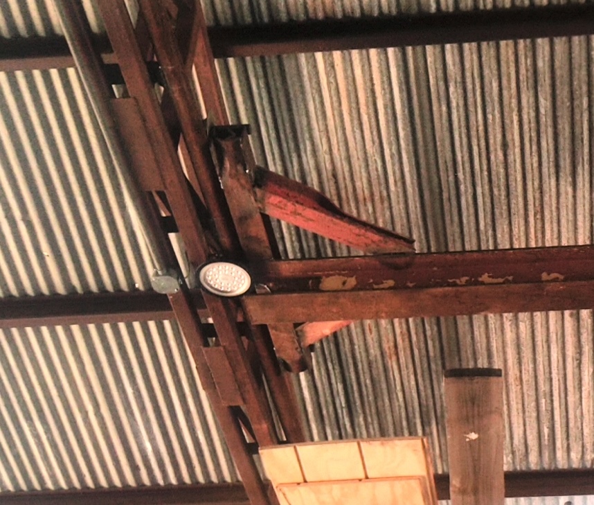

    Hanging the bridge
    Only thing left is to come up with a hoist for it then testing.
    Truss calculations show the trusses can support a 10k load at the center of the 68ft span, the 14 ft bridge is good for 3 tons center of span but I am only looing to install a 1-ton hoist,
