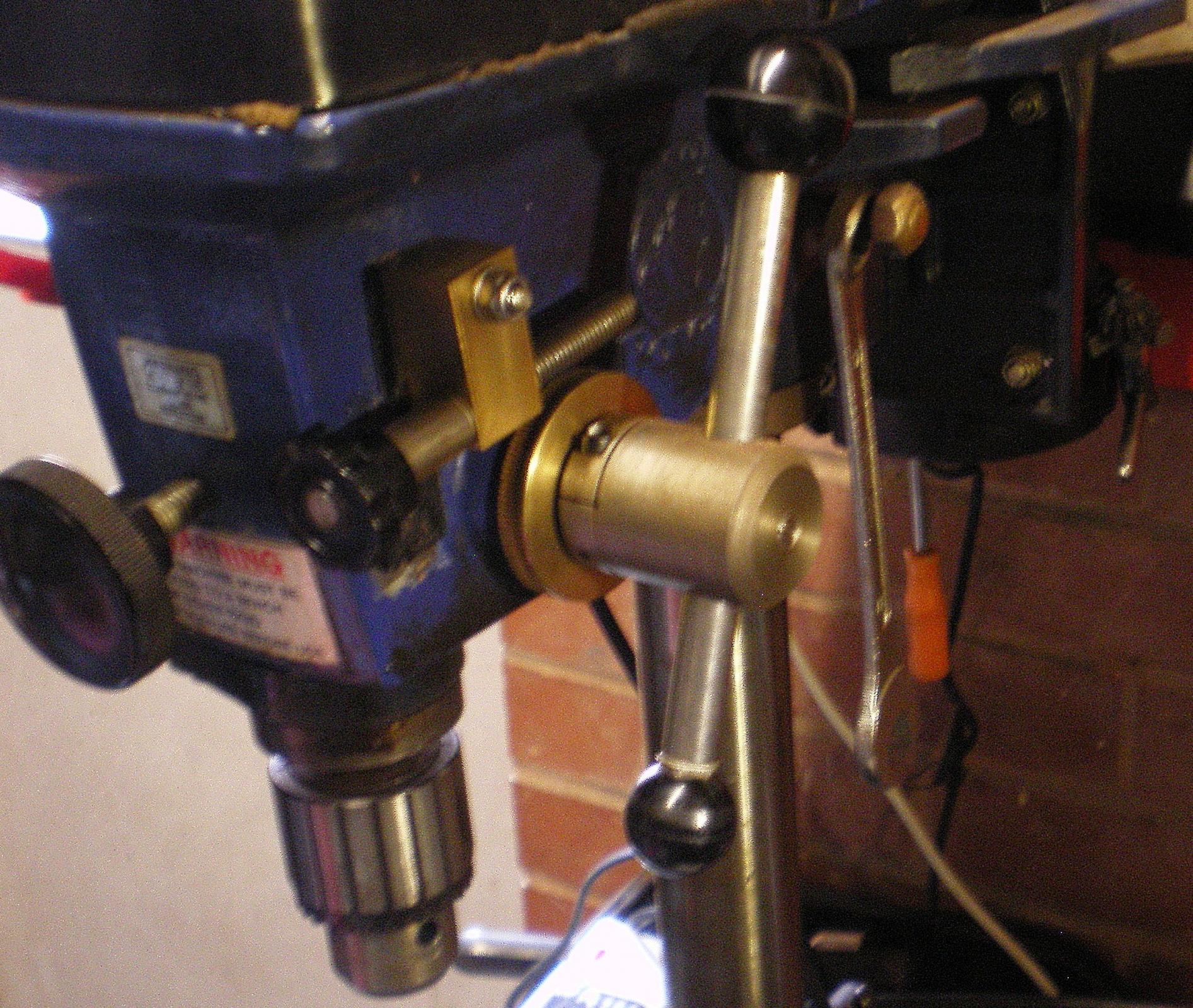

    A great idea for larger bench vices.
    The indent is not really essential as a stronger spring with a brass pad will retain the handle in any position. I have done this on my drill press handle mod and it works very well.
