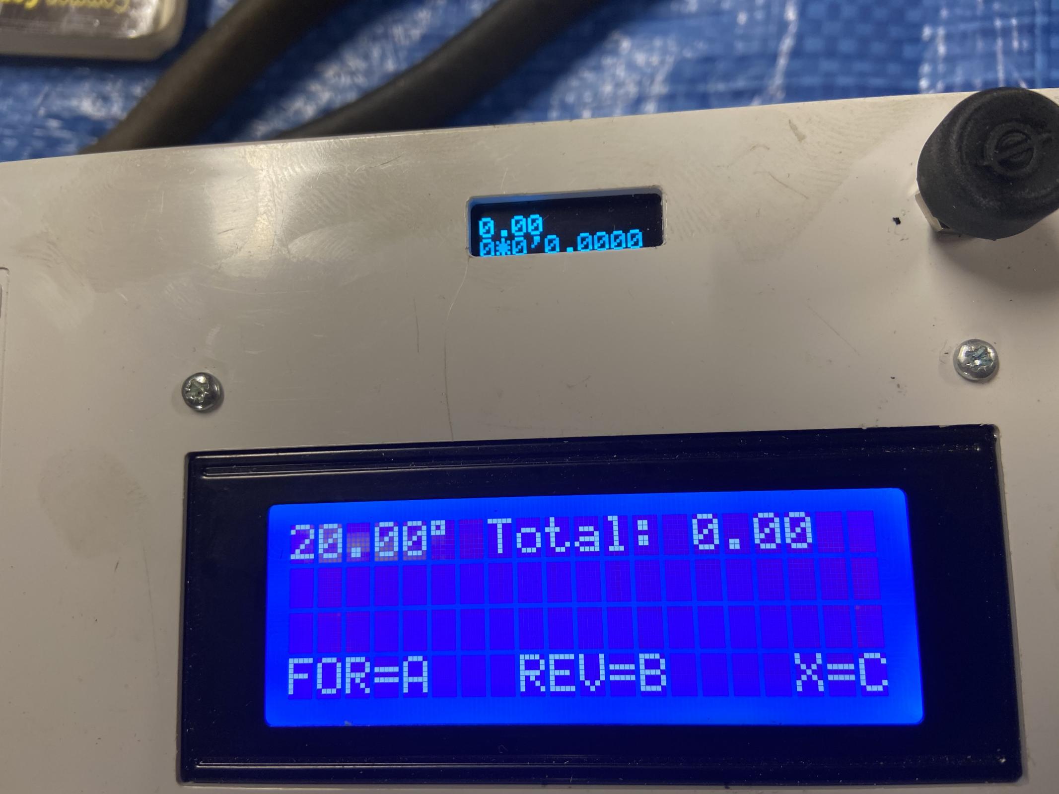

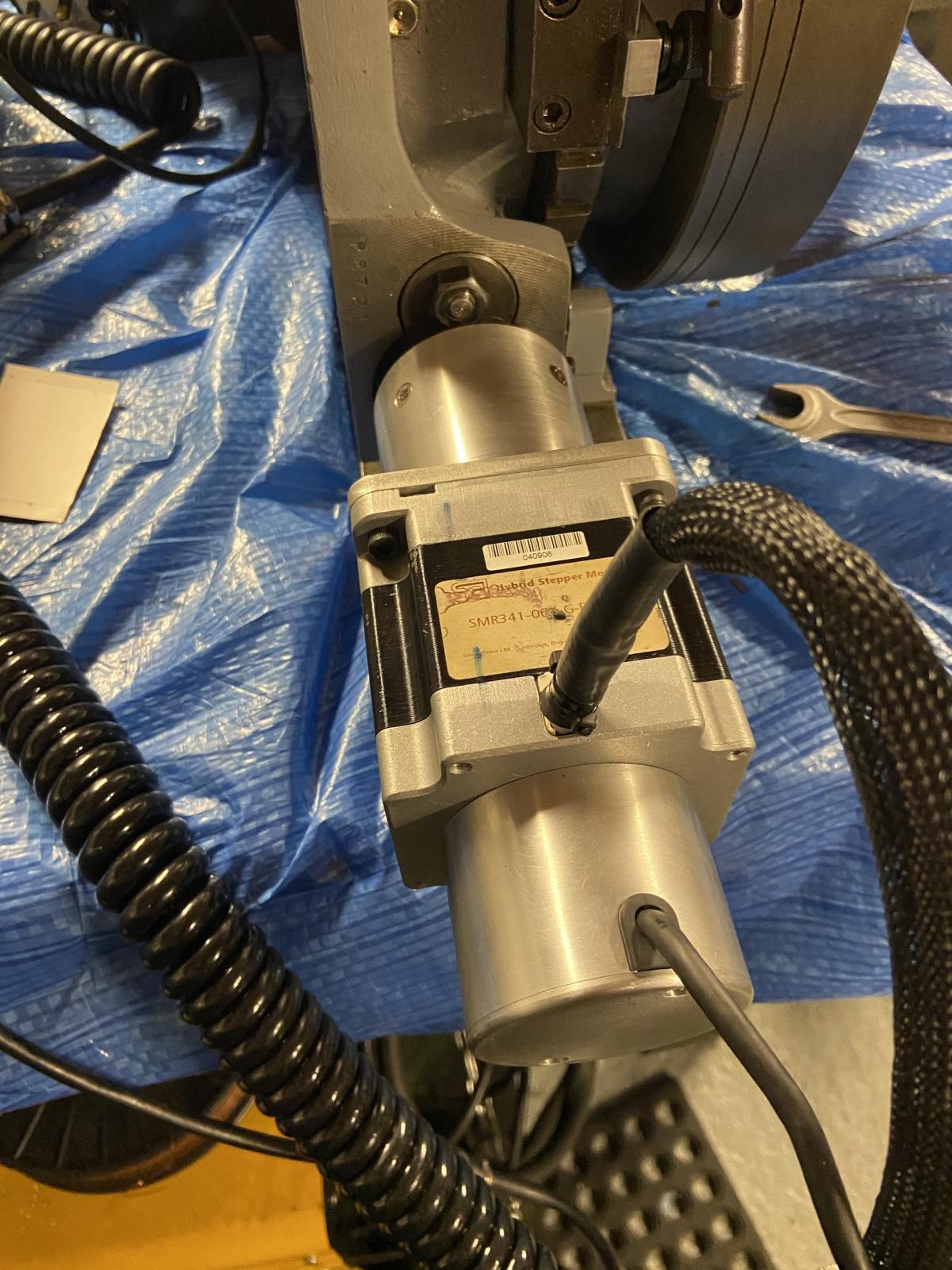

    hi All
    I have finally attached the stepper motor and encoder and had the rotary table moving.

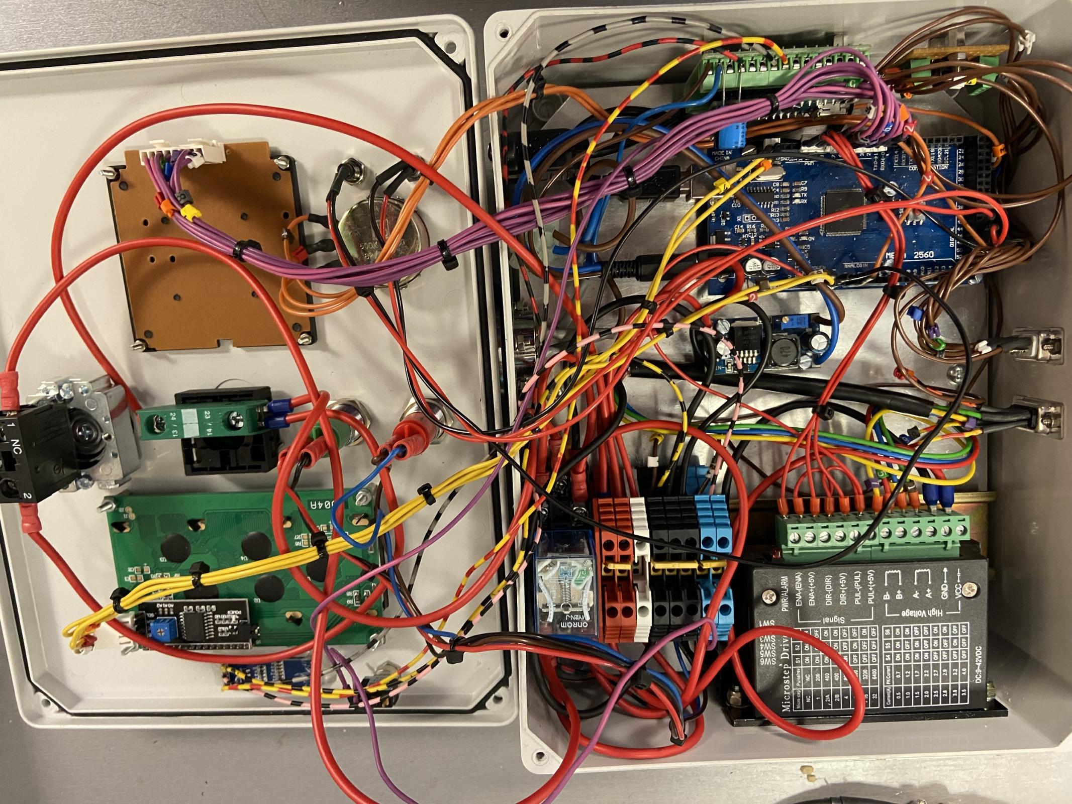

    After testing there are a couple of issue that need attention 1st being the variable feed/speed control via a potentiometer. When turned to full rotation it stalls the motor. 2nd I need to check the coupling is tight on the motor shaft and the control box wiring is somewhat messy and will need tidying but as this is the first time I have ever taken on a project like this. It was very much a, make it up as you go along just to get it working and then worry about the presentation at the end.
    The main control is via a Arduino Mega and TB6600 motor controller and the encoder uses a Arduino Nano.
    I did have a lot of help with the programming. Without this help, I don't think I would have completed the project with all the features I wanted.

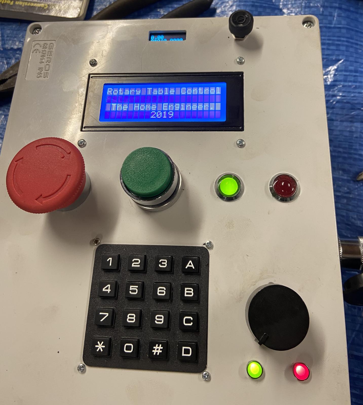

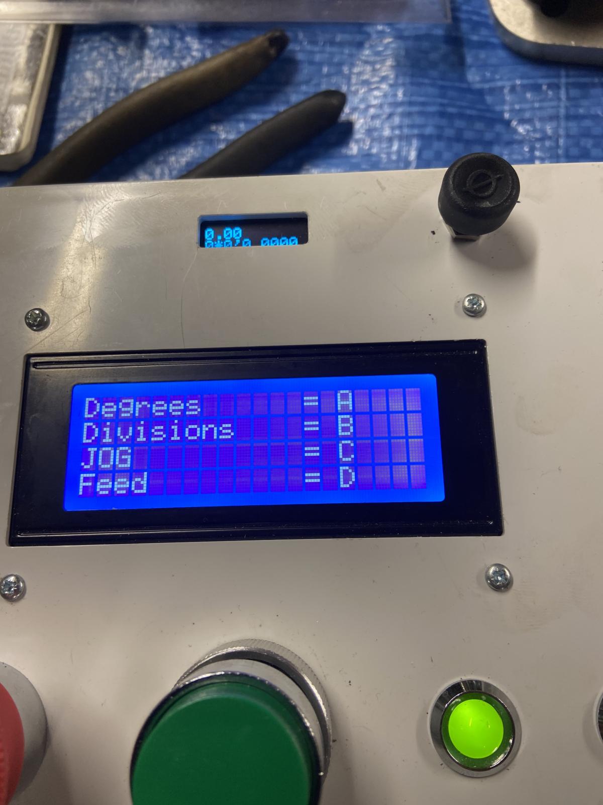

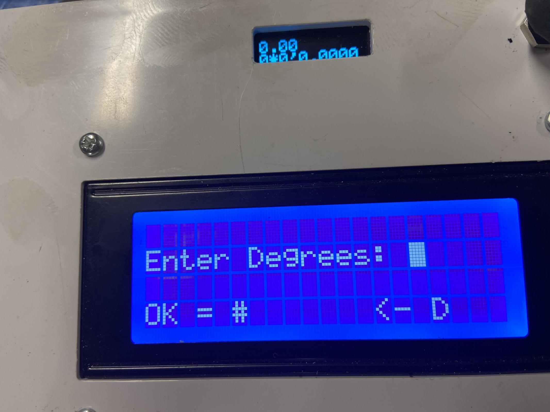

    The control box has four modes. Degrees, Divisions, Jog and Feed. The Feed is controlled via a potentiometer, which I want to change how this controls the table.
ID:	33045 Needs a little tidying
Name:	setup sequence.jpg
ID:	33046 Start up
ID:	33047 Options that can be selected

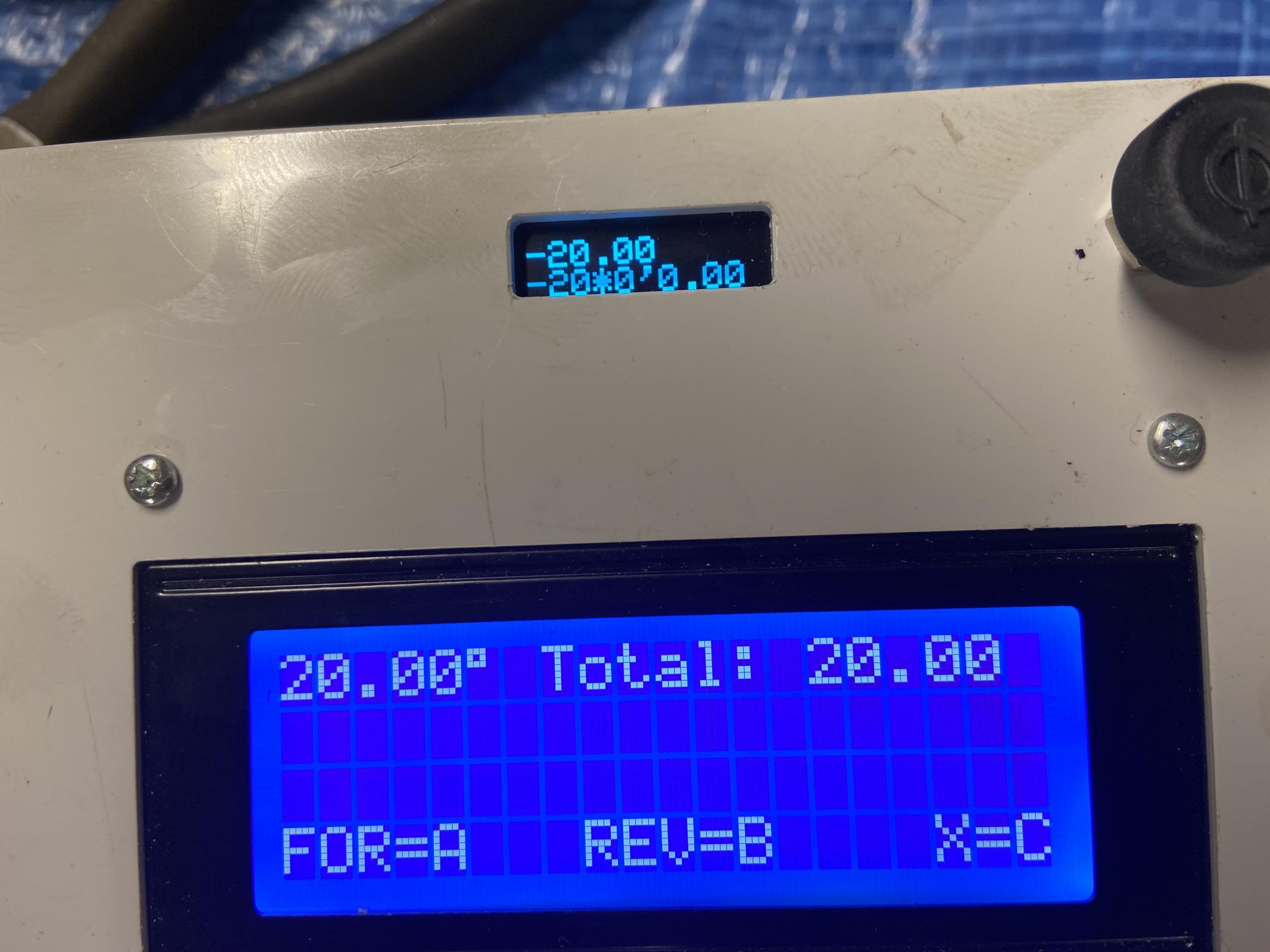

ID:	33050 Degrees selected
ID:	33048 Selection set to 20 degrees and ready to move table.
ID:	33049 Angle travelled and small top screen shows position via encoder. Very pleased with accuracy.

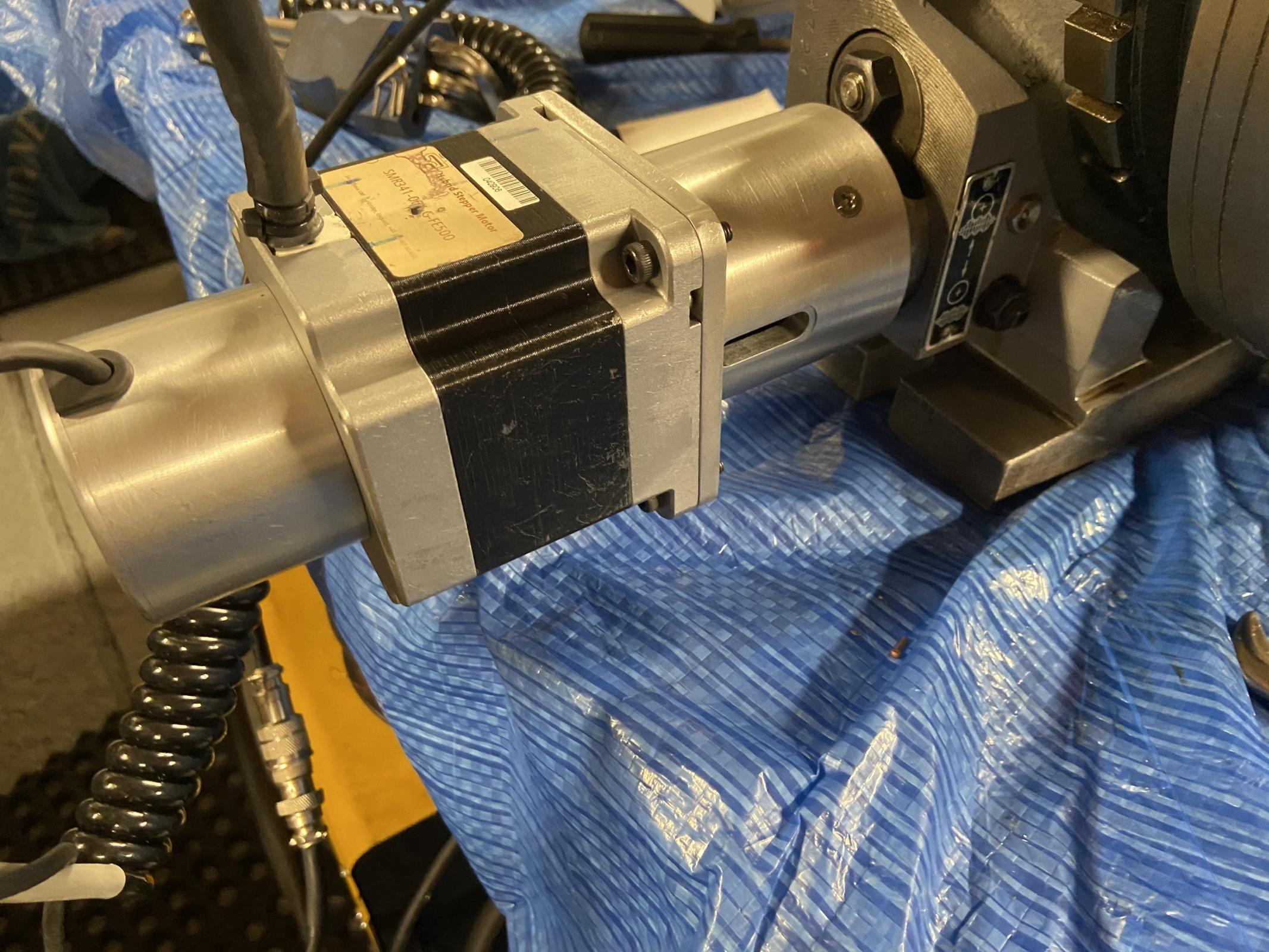

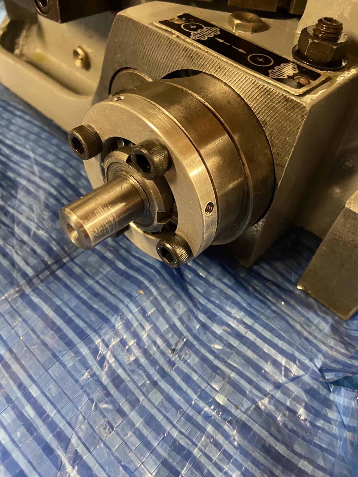

Name:	stepper motor adaptor plate.jpg
ID:	33051 Aluminium adaptor plate to connect stepper motor to table
ID:	33052 Click image for larger version.
Name:	motor inplace.jpg
ID:	33053 Motor and encoder in place
