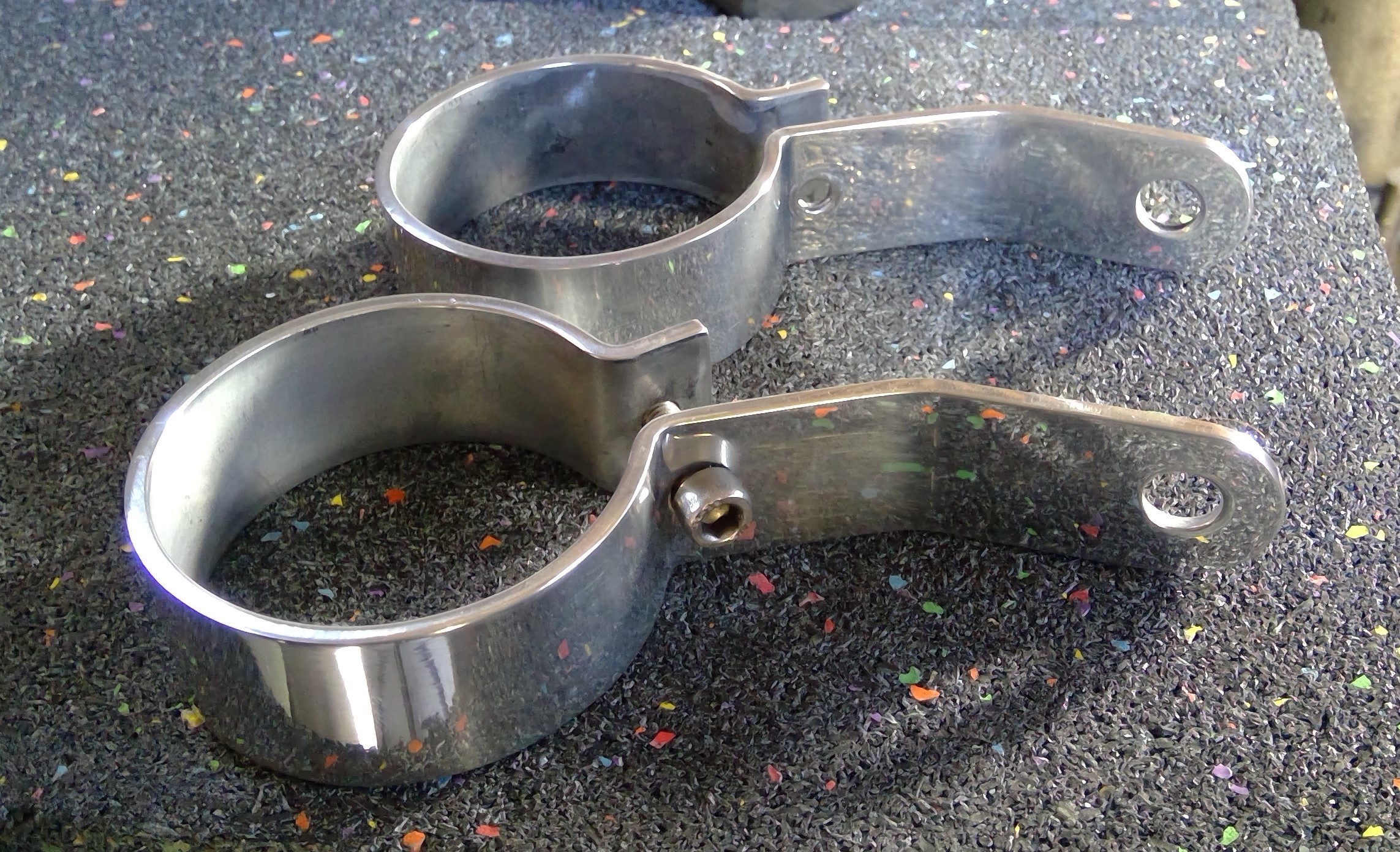

    Completed the last job today, fitted the baffles to the mufflers. All that's left to do now is rip the bike apart and repaint, then reassemble. Don't know when though, I like looking at it now it's finished.
    I'll be repainting with the same black, but this time applying an iso free two pack clear over the base colour coat on some selected parts: tank, seat, guards and maybe a few other bits.
    When resprayed and assembled I'll fit tyres and get the the seat covered, don't trust the upholsterers with the seatpan, that's why the two pack iso free clear on the seatpan before getting it covered. I was going to cover it myself, but the Singer has given up the ghost.
