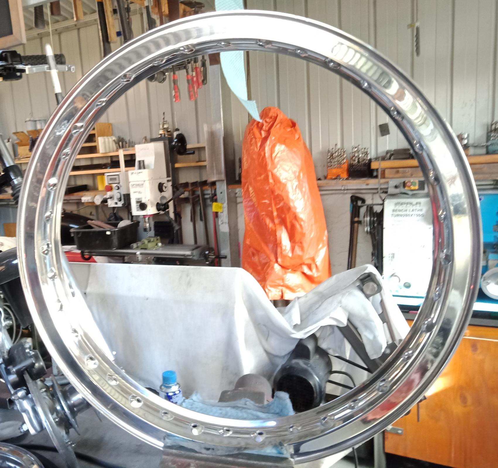

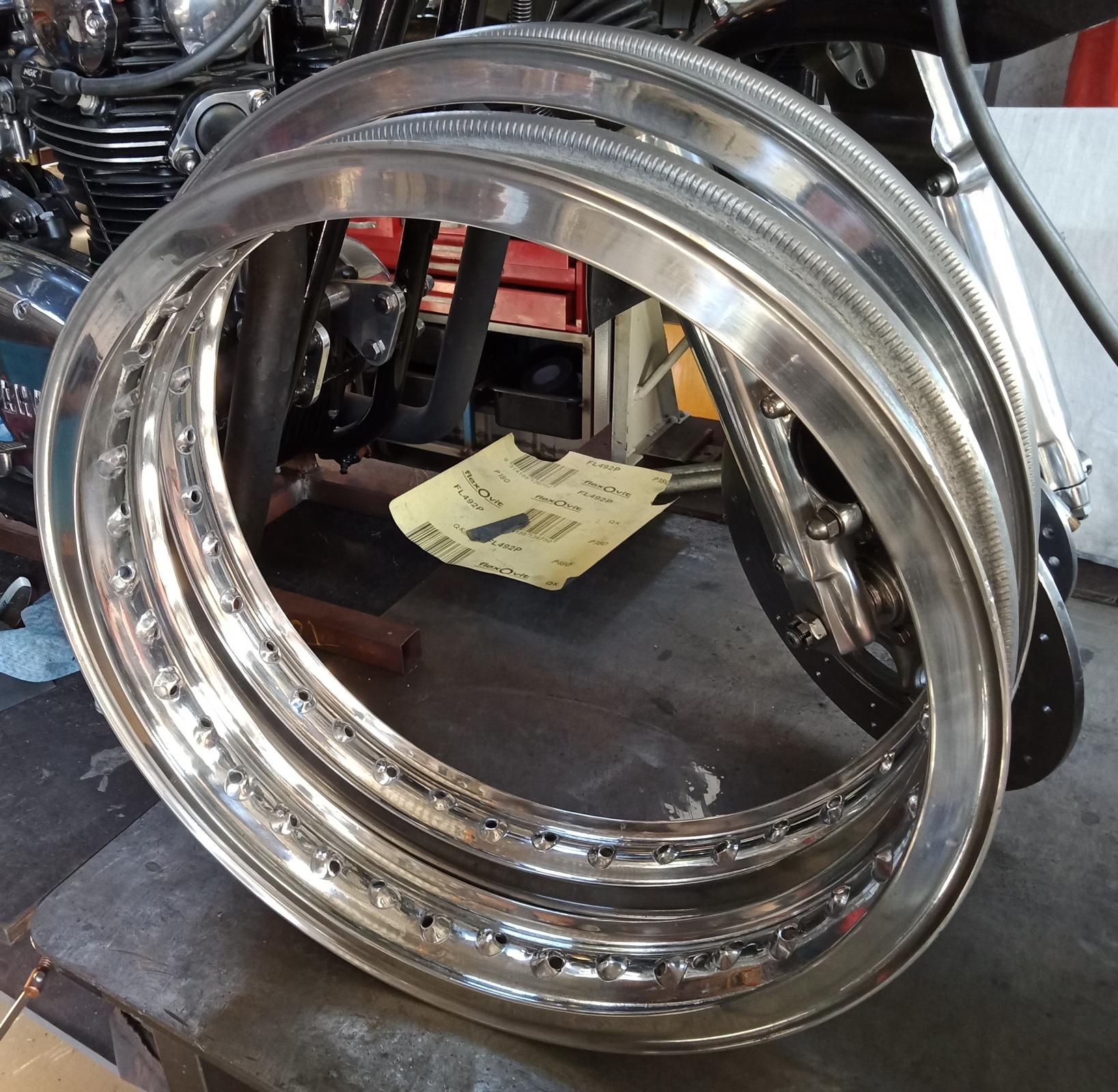

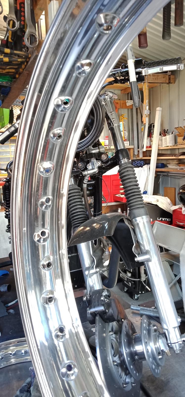

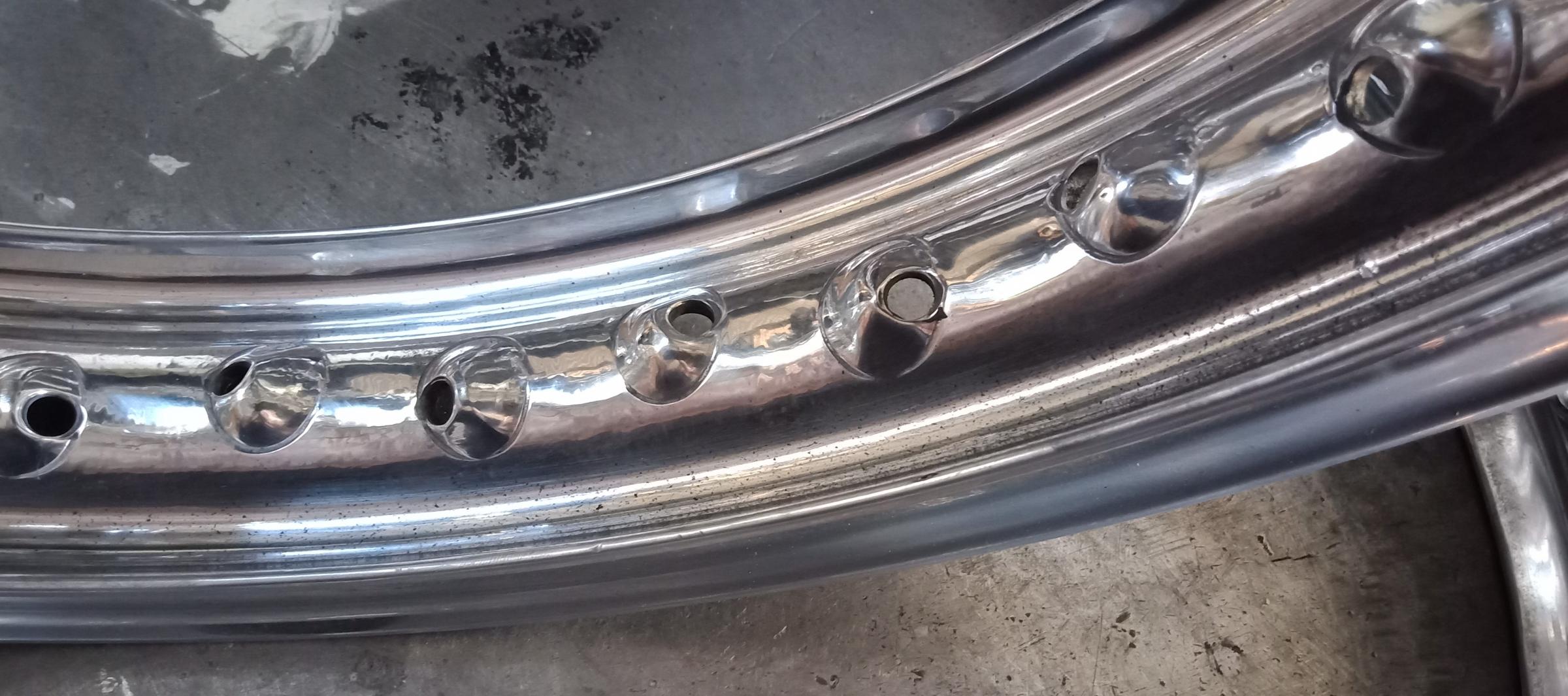

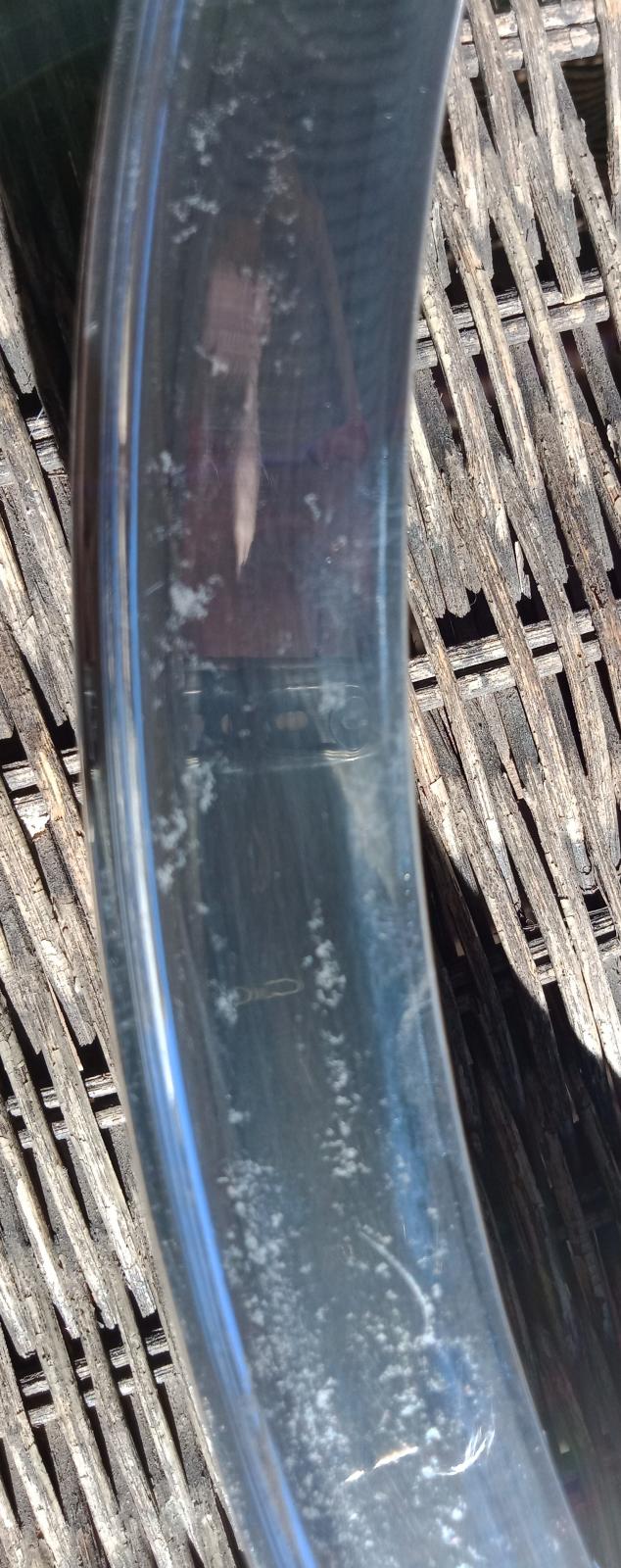

    Did some more buffing on the front rim, came up reasonably well, I ground the edge down and managed to get rid of the lever marks, but as you can see in pic four the pitting is very bad and very deep, no way of getting rid of that. Pic five is the rear rim. I still have to grind down the edge of the rim to remove the lever marks. Very badly pitted and the area between the nipple lands is very uneven. I'll attack that next but not sure if I'll use them, whilst they look nice and shiny , get up to within a few inches of them and the pitting doesn't look nice. More procrastination required I think.
