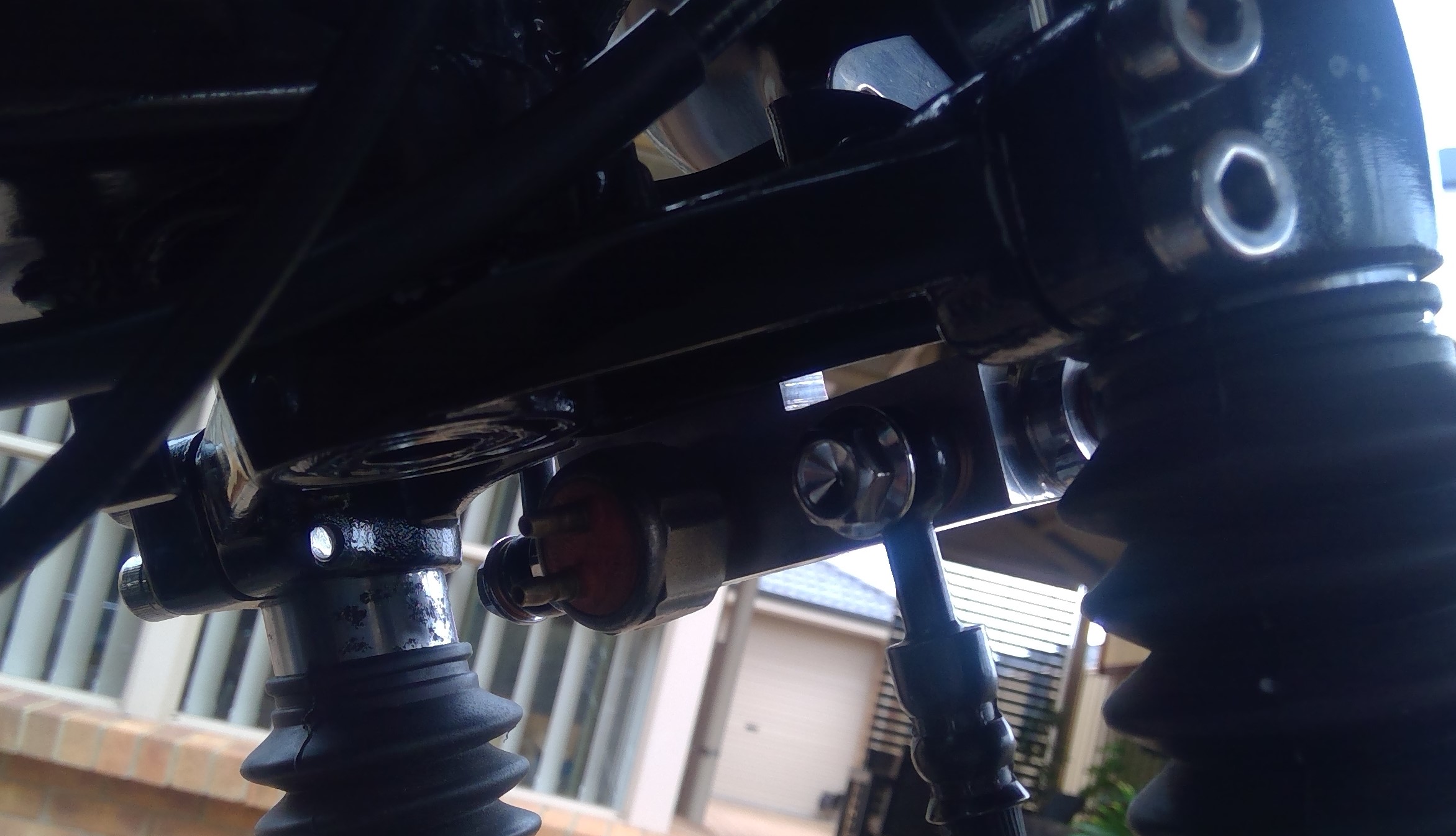

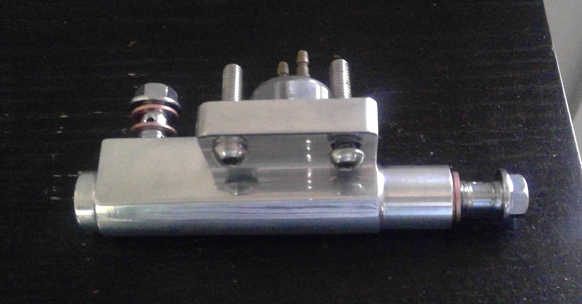

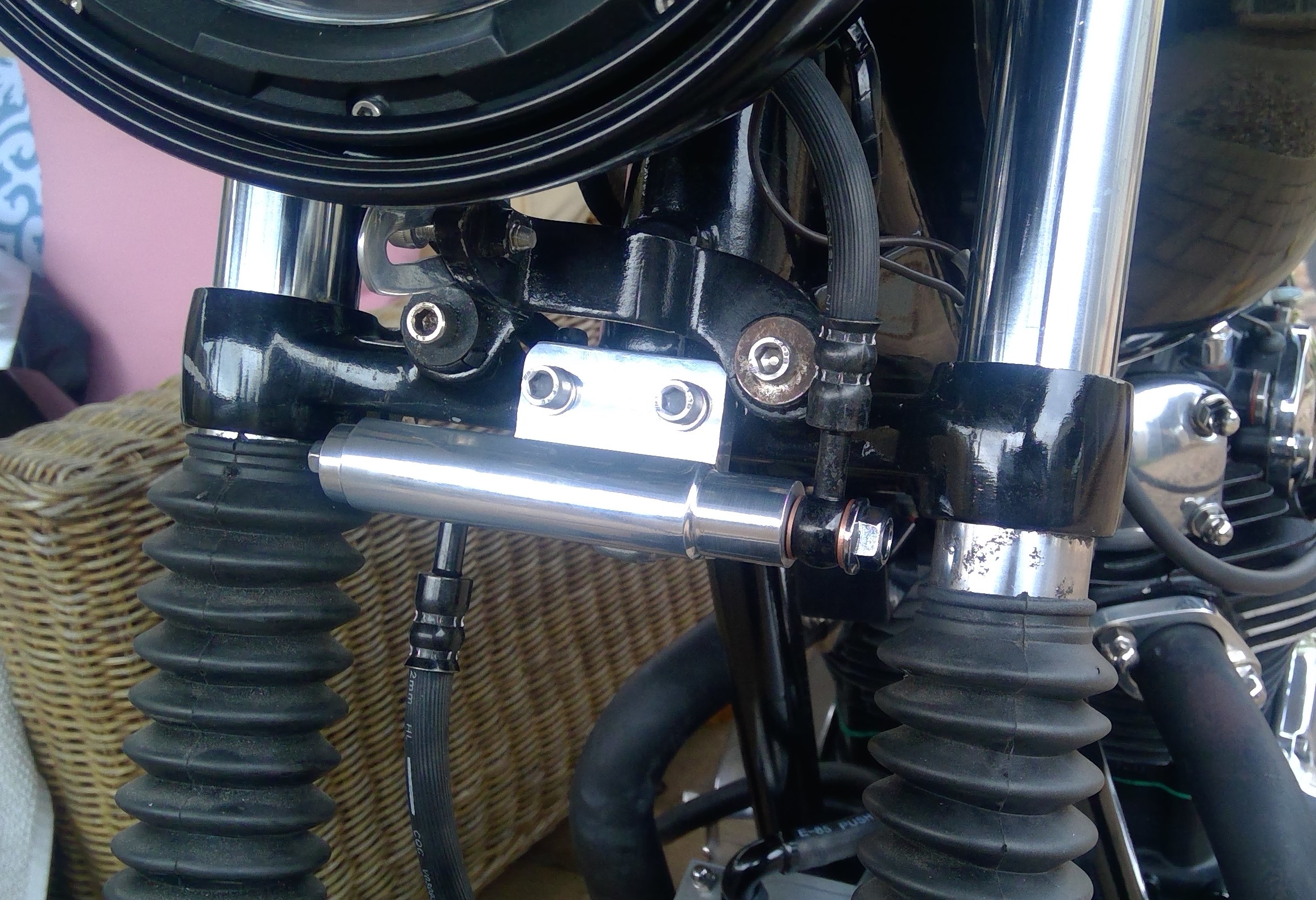

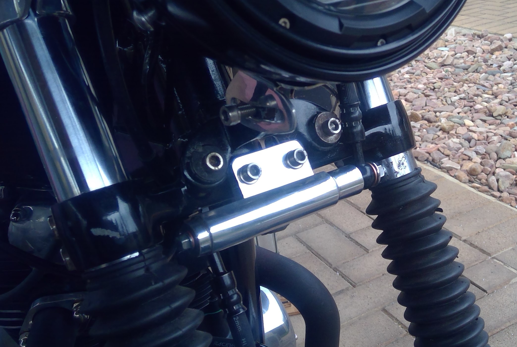

    This is a new brake divider I machined up to replace the original. The original hoses were rotted, so I replaced them and did away with the two steel tubes that connect the hose to the calliper and the hose from the master cylinder to the divider. Unfortunately, the new hoses have the banjos on the same plain requiring the lower hose to be twisted through 90degrees to connect to the original divider, so I machined a new divider to get around the problem. The lower hose connects at the rear of the divider, as does the brake light switch. The top hose connects to the side of the divider.

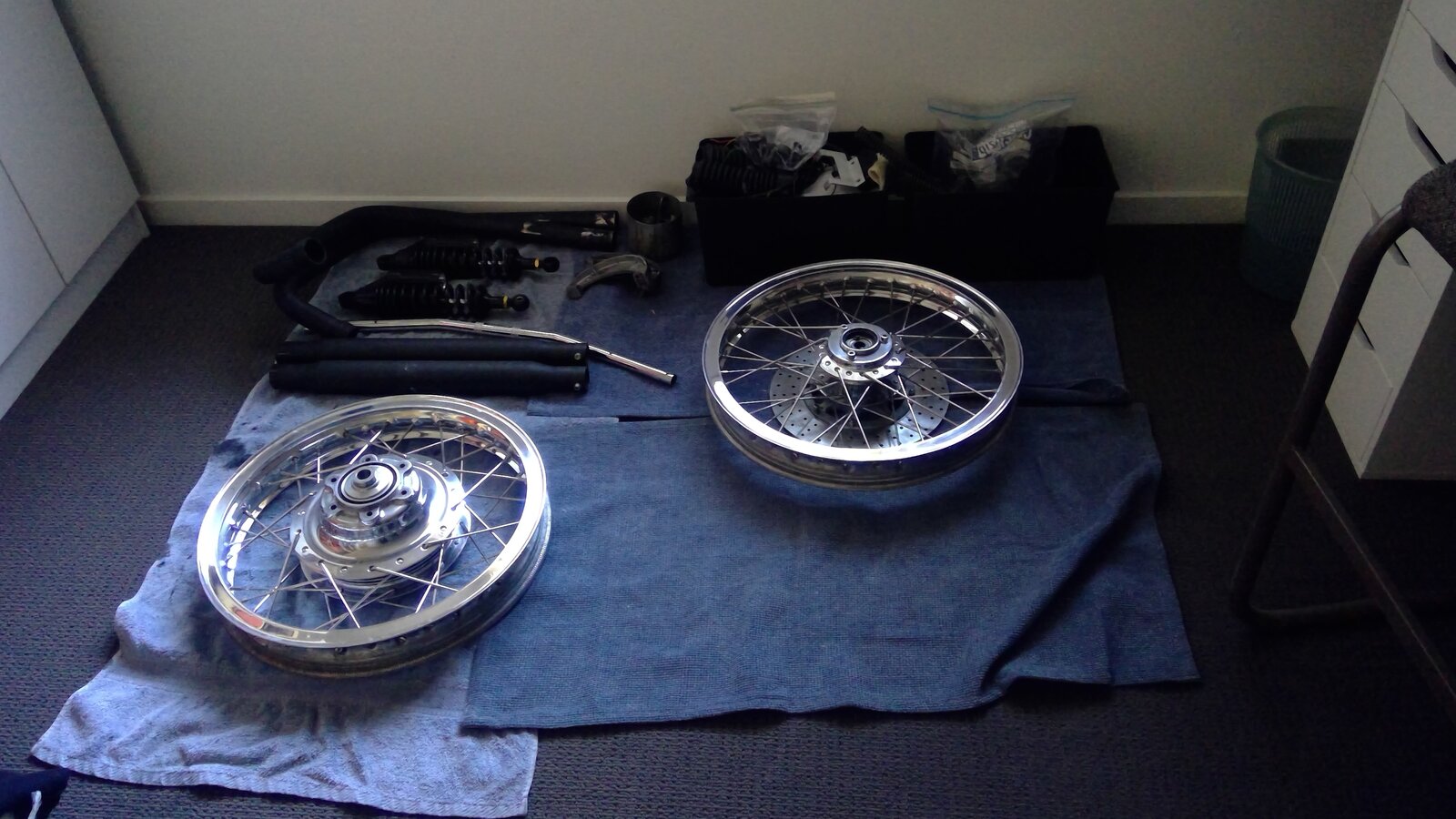

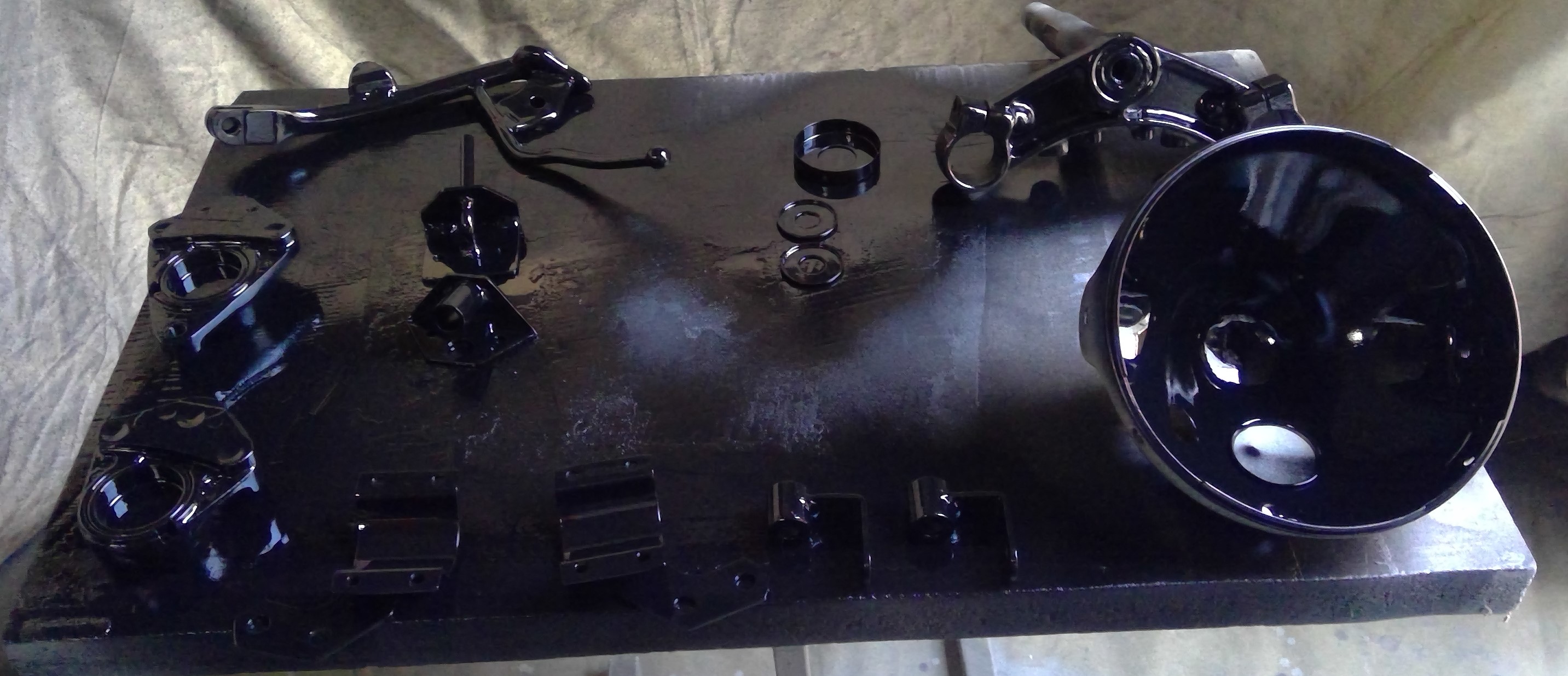

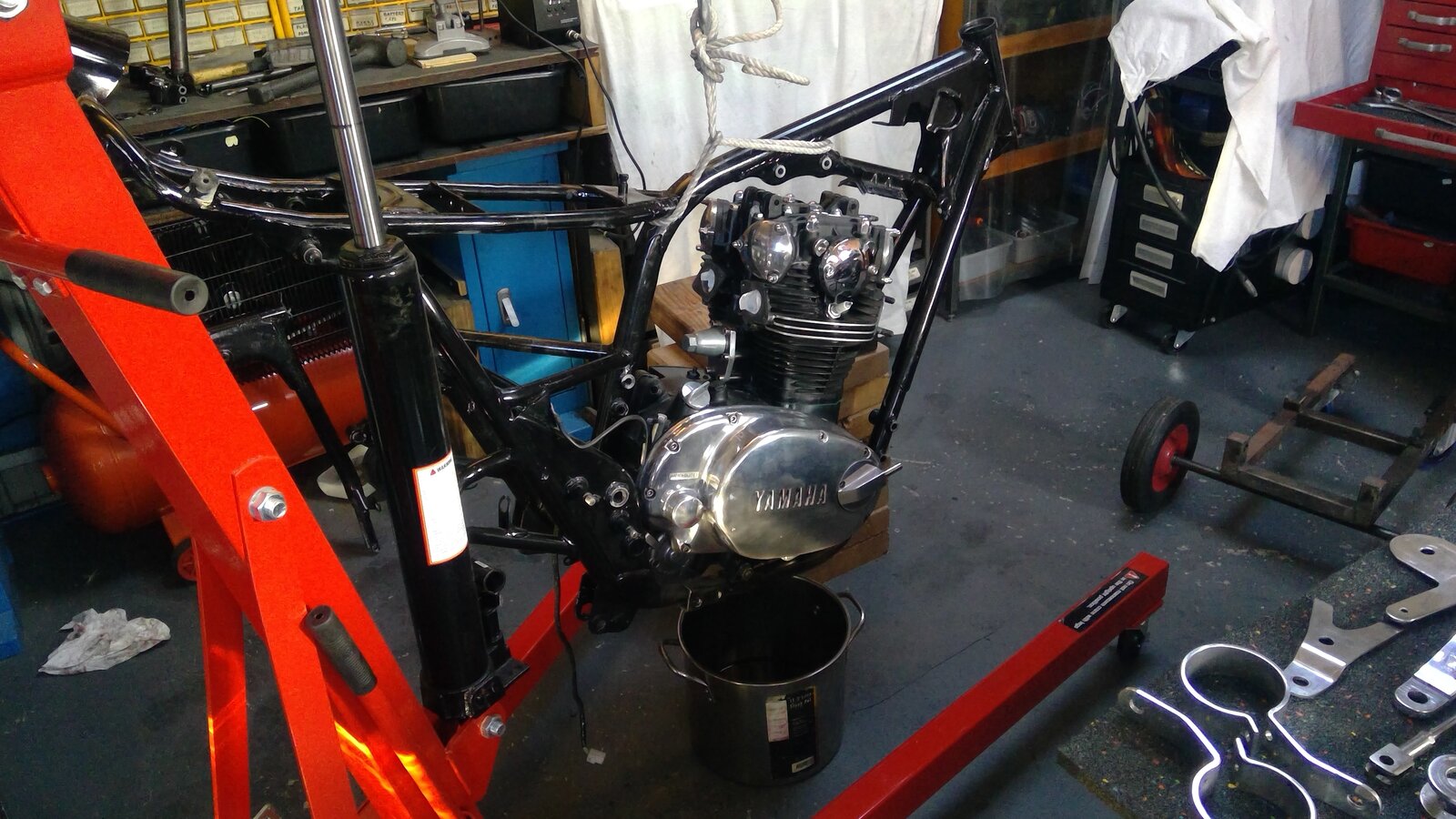

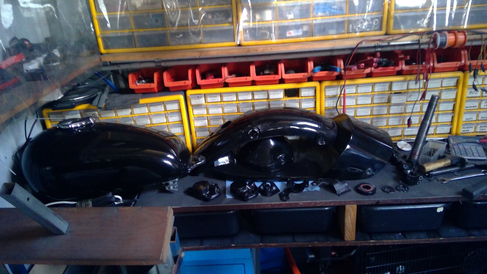

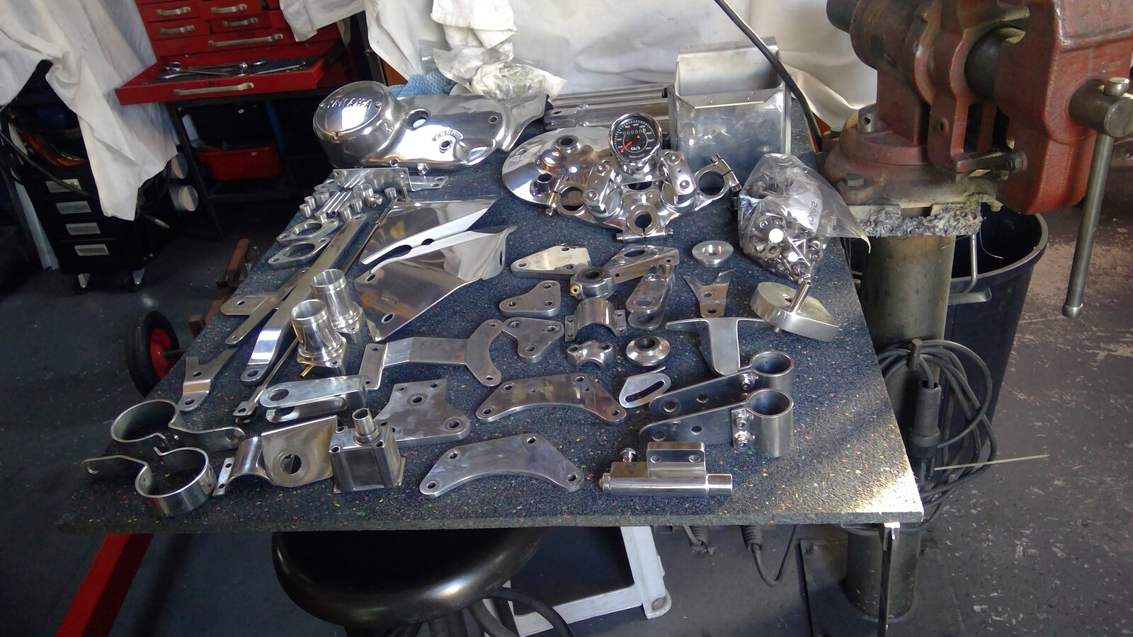

    A few hours is all it took - it's just a pile of bits that once was an almost complete bike now, just needed tyres and the seat covered. Going to be a big job polishing all those bits again, any volunteers???
    A couple of mods on the frame to do: Remove the coil and flasher mounts then repaint along with tank, guards, seat, trees and a few other bits. Not sure what paint to use this time. I used acrylic lacquer last time, but spilt some petrol on the tank and it stained it. Painted heaps of tanks with acrylic lacquer before but never had this problem, either the paint is different or the petrol is. Don't really want to repeat the exercise.

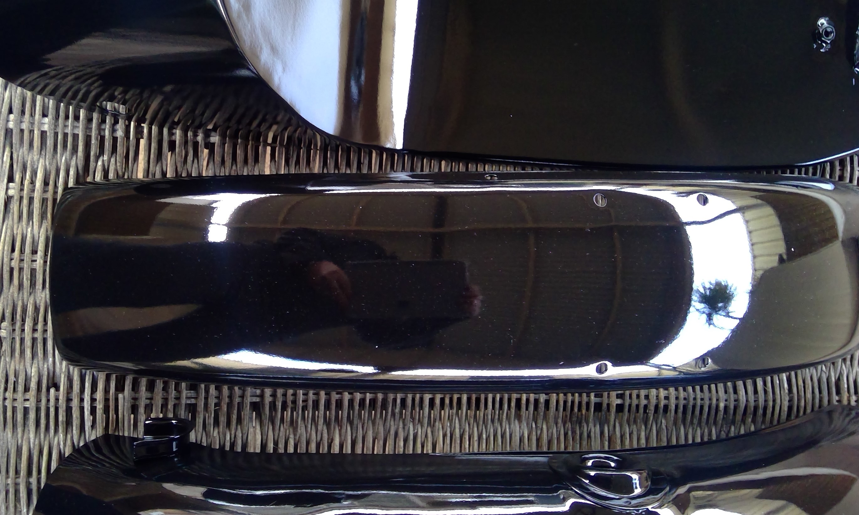

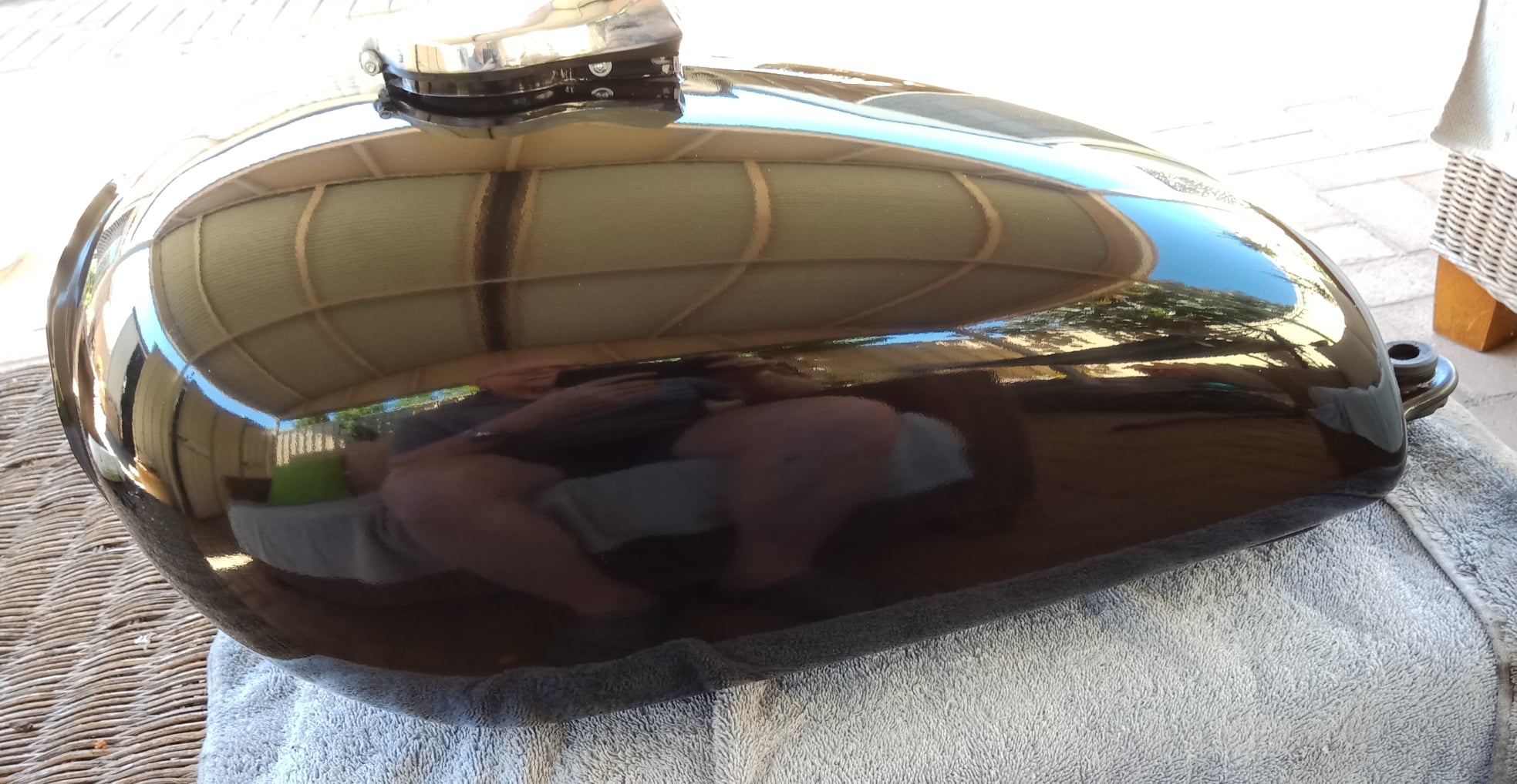

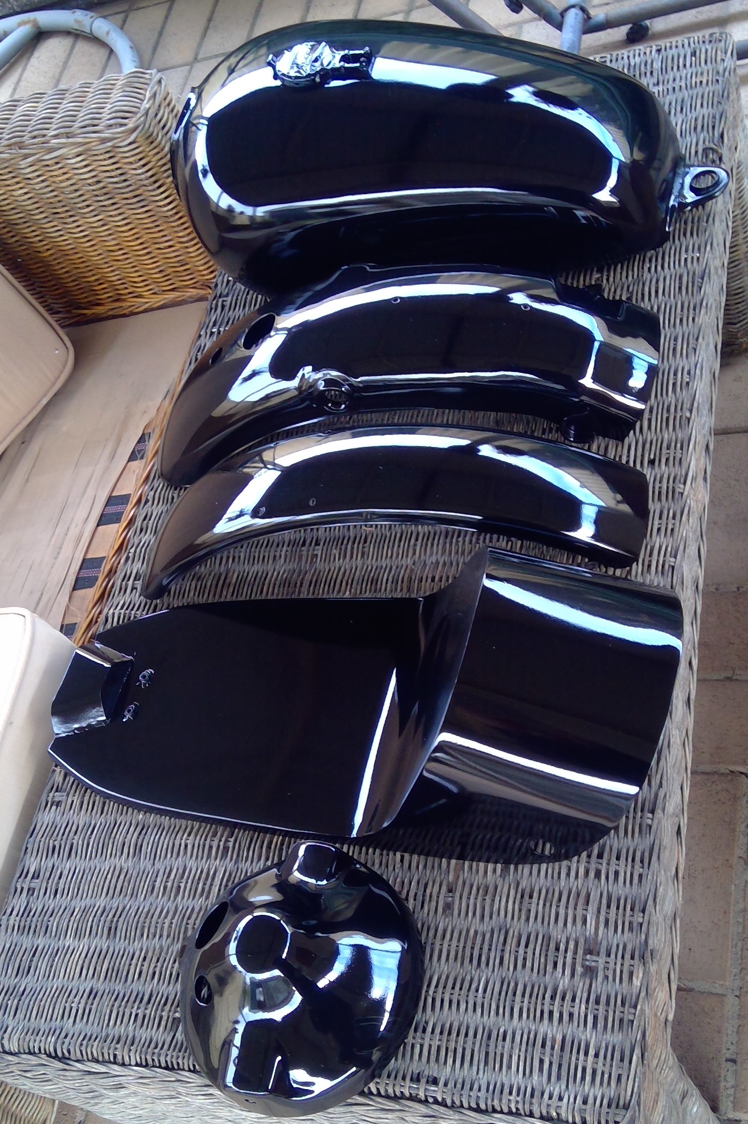

    Applied the final coats of acrylic lacquer to the tinwork and some ancillaries this afternoon, didn't come out as clear or as good as I hoped, but acceptable I guess. I'll give it a few more days then sand the tank and spray over with 2k clear. Not the done thing, technically, but plenty do it, so we'll see how it goes.

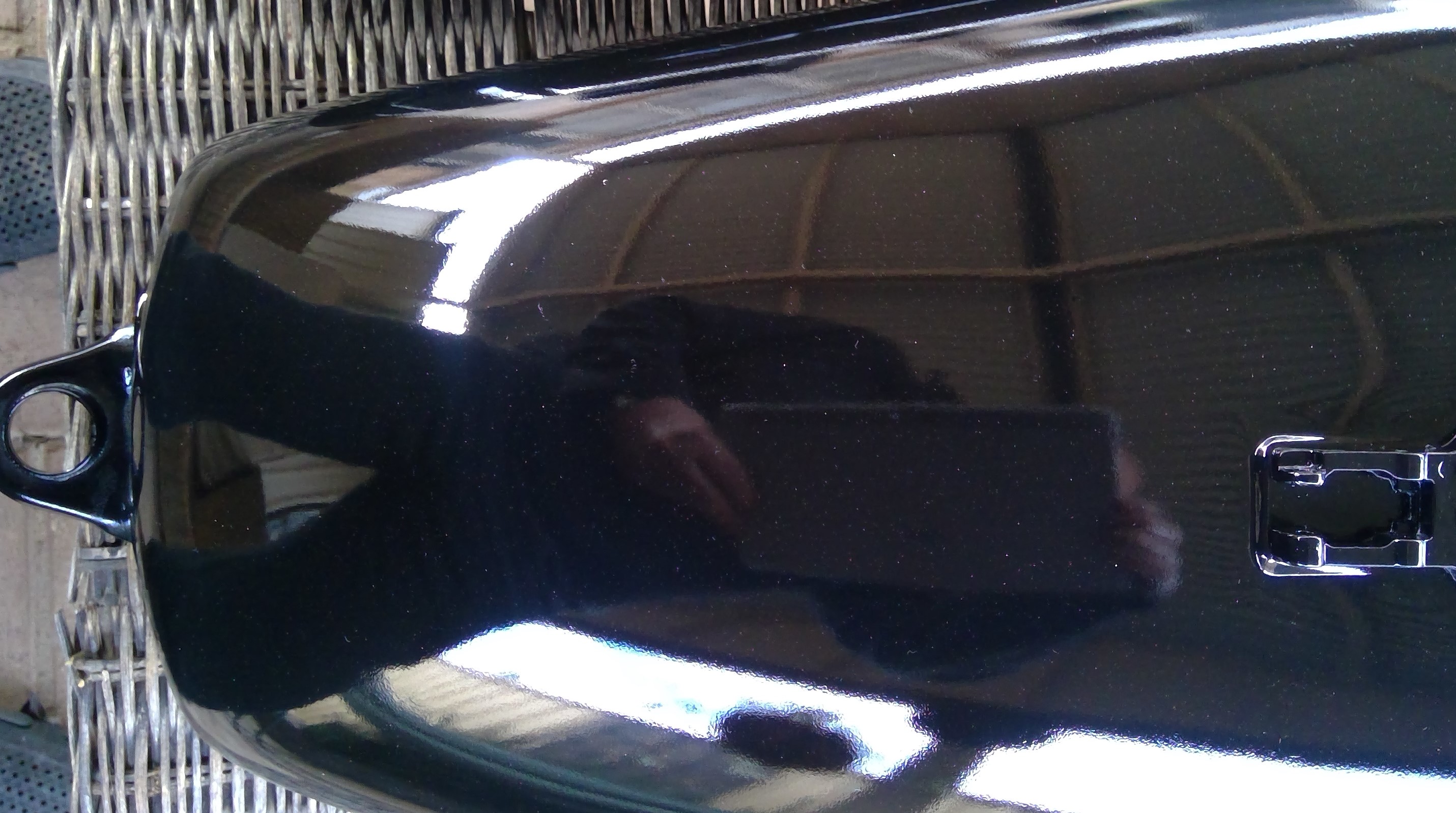

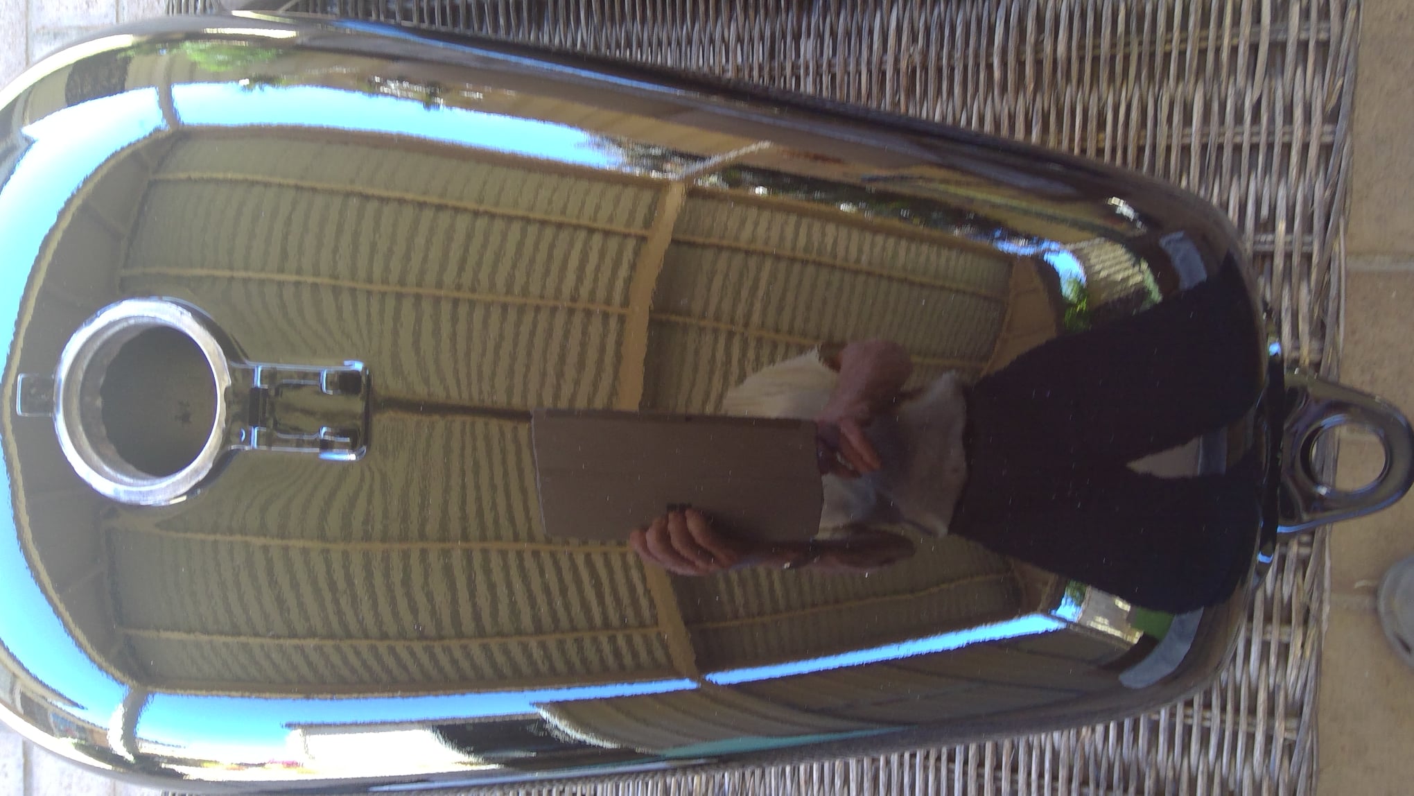

    Depends on your technique. The tinware in the picture is straight off the gun. This was my first paint job on the tank, again, straight off the gun.

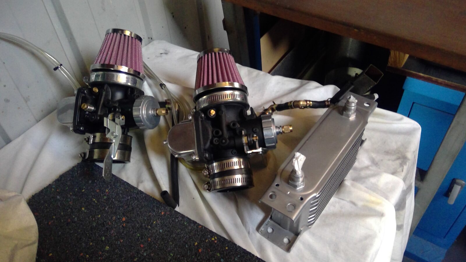

    Carbs were blasted then pressure cleaned and blown through with air and reassembled and bolted in place on new rubber manifolds. Clutch, starter gear, and alternator were all bolted in place and I was ready to start it up. First cleaning the strainers, filling with oil and turning the engine with a cordless drill to get oil circulating .
    Rather than start the engine up on the bench stand and watch it vibrate across the bench and fall on the floor, I built a new stand on wheels, added a fuel tank bracket, mounted the regulator, condensers, a couple of Bosch coils, a Honda solenoid, installed a $4 ebay three phase rectifier (used OEMs are $70) wired everything up to a rocker ignition switch and momentary starter switch and pushed the start button. Damn thing roared into life immediately and damn loud with those pipes. If you think Brit twins vibrate, this thing leaves them for dead, I had to tie it to the bench grinder stand to stop it walking around the shed.
    I made up a manometer and synced the carbs, then stood back and looked at it. Nope don’t like it, too bland in silver. So, up on the bench again, rip it apart, blast the paint off and repainted it black, then do it all again. Much, much better.
