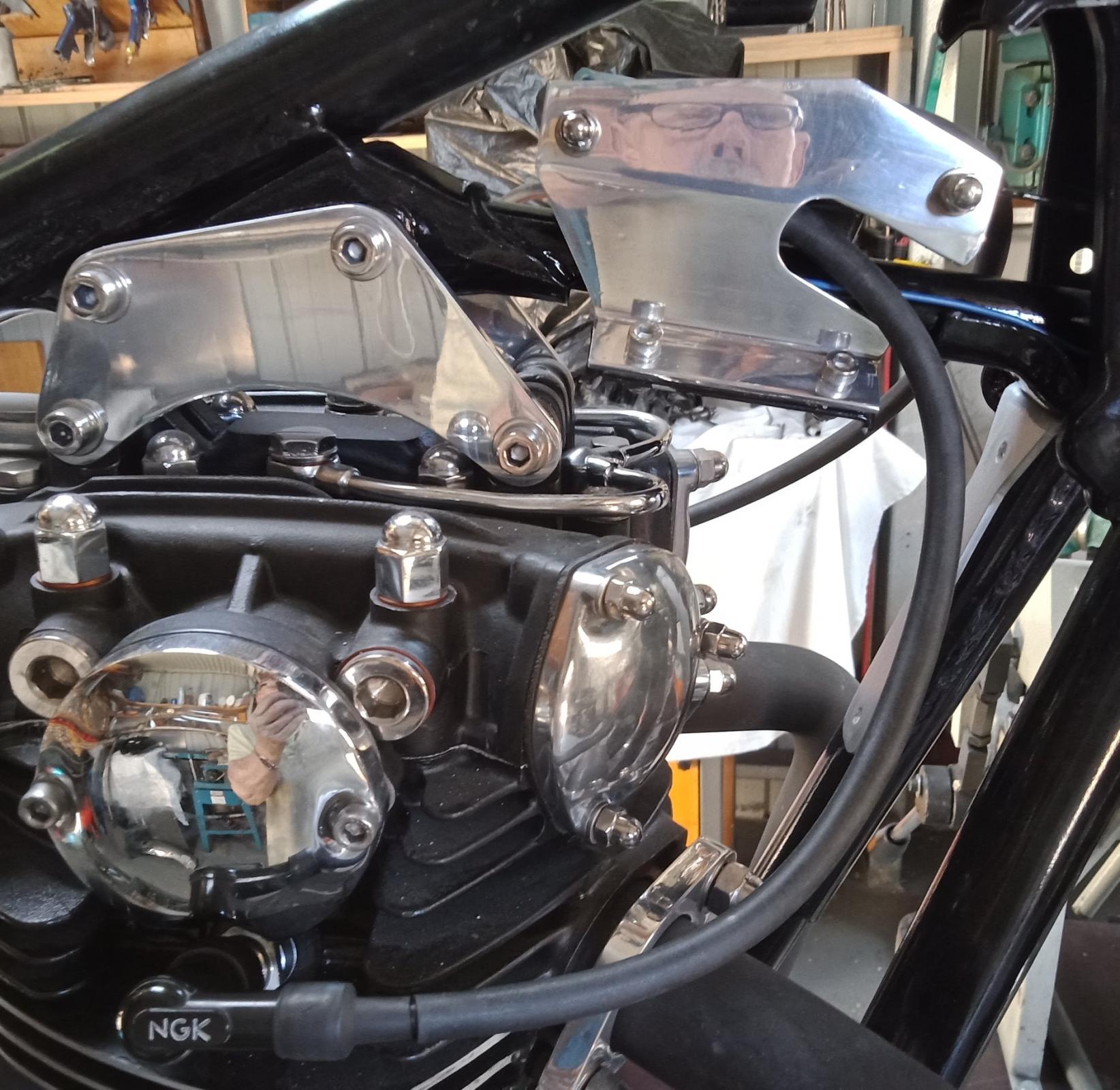

    You might recall the coil mounting bracket I made a little while ago. I mounted it on it’s side because there wasn’t room between the frame tubes to mount it right way up. This meant the two plug leads were a different length and took different paths from coil to plugs. I said I could live with that at the time, but, I couldn’t, it just hurt my neatness sensibilities too much. The problem was the two, long, mounting bolls either end of the coil, they were simply too long to fit between the frame tubes so I discarded them and made a new bracket that the coil ends bolt straight to, negating the need for the two long bolts. This of course required some fancy bending of the bracket to get the mounting holes in the centre of the backbone tube and at the right height. A certain amount of cutting and removing material was also required so the coil would sit flat and far enough away from the tab for mounting the flasher can. But, success, I managed to get everything right on the second go, so now the coil sits right way up and most importantly the plug leads are identical in length and take the same path to the plugs. You’ll notice the rear coil bolt is a mickey hair away from the backbone tube. I could have mounted the coil further forward, but that would render the tab in front useless for mounting a flasher can. Unfortunately, it doesn’t look quite as Smick as the side mounting bracket, but I can live with that – I think?
